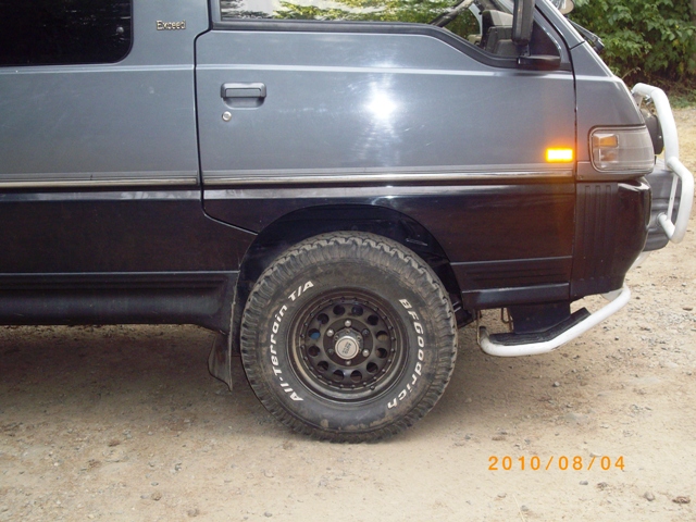

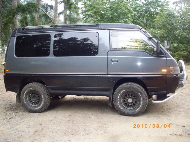

some mods done over the past few months
and finally i painted my rims a while ago

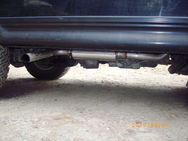

upgraded to a 2.5 inch exhaust

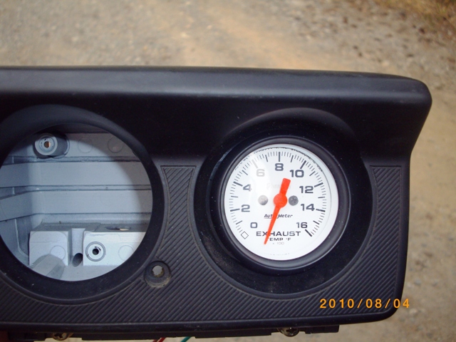

puttin in a pyro and booste gauge

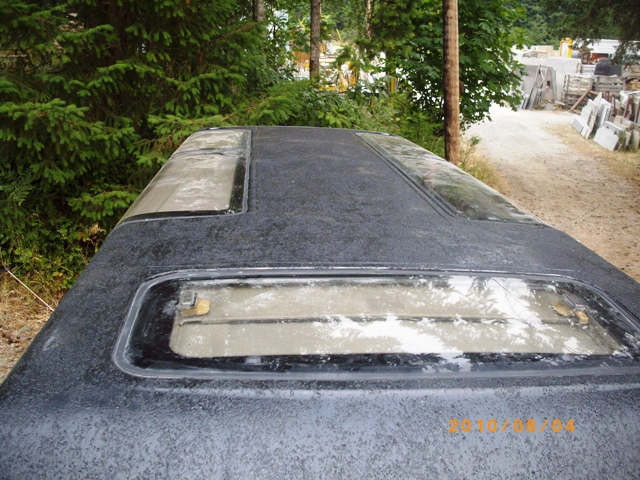

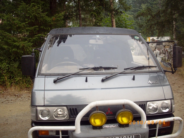

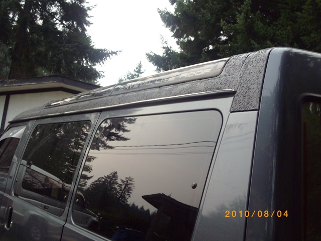

here are my last few mods starting with this past long weekend i tackled my very rusty roof... cant find any of the pictures i had of it before but i put a polyurathane box liner on it after hours and hours of grinding sanding bondoing sanding and sanding

Very Nice ...... Time to heatgun the plastic Mitsubishi box on the front bumper to make it black as your roof

Heat gunning the plastic draws oils deeper in the plastic to the surface. This will eventually result in the shroud cracking. Put a vinyl treatment on it in stead.
