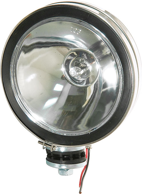

If not, I will have to find some pipe holders because Princess Auto had these on for $12 each, so I bought four:
$12 each!
$12 each!
I know that they won't be as good as some of the other lights out there. But, I also know that what really makes the difference is the quality of the wiring and what bulbs are chosen, so those are pretty easy things to modify for a $12 base!

Mr. Flibble wrote:But, I also know that what really makes the difference is the quality of the wiring and what bulbs are chosen, so those are pretty easy things to modify for a $12 base!
:shock: so you're saying with the right wire and an expensive light bulb you get almost the same quality product as from well known brands as Hella, PIAA, Lightforce, etc?
Mr. Flibble
Posts: 1396
Re: Princess Auto 6" lights on the Bull Bar
Post by Mr. Flibble »
Pretty much, unless you go to HID there is not much of a difference. Granted HID is much better than Halogen, but other than minor differences in lens focusing, I really don't see what is different other than the amount of marketing material you get with each light! After all, if your Hella or PIAA lights burn out, you replace the bulb with another bulb, which is the same thing you do with these Princess Auto lights.

Not sure where you got your info from but it's incorrect.
Taking the same bulb out of my 9" Lightforce mammoth offroad lights and put them in a 9" Procomp housing (same as yours from PA) and the difference is staggering. The procomps looks like a dinky kids flashlight compared to the Lightforces which can burn a hole in your pants.

Mr. Flibble wrote:...other than minor differences in lens focusing, I really don't see what is different other than the amount of marketing material you get with each light! After all, if your Hella or PIAA lights burn out, you replace the bulb with another bulb, which is the same thing you do with these Princess Auto lights.
Well, you will see the difference once you have your lights for a while. The housings, seals and mirror will corrode away. Oh and try to throw a rock against your light and against a Lightforce housing :)
I agree Falco. HID is hard on your eyes when you see other cars with it. BUT it's absolute amazing as an offroad light. Just so much brighter.
Mr. Flibble
Posts: 1396
Well, yes, this is true! There is no Fresnel on the lens, and I bet you are right, the glass is much thinner. So, I expect the direction of the light to not be as good as it could be with a better lens. But then again, I get 4X the bulbs/lights for an equivalent PIAA lamp price. (I have 2 PIAA foglamps on my Deli). 4 cheaper halogen lights will beat a single Hella or PIAA halogen light.
I also know that the rear sealing behind the cable on these lights (they have not arrived yet) does not exist, but I can fix that with a little caulking. So, as long as the mirror coating does not flake off (that is a valid concern!) then these lights should do me just fine. After all, I only want them for lighting up logging roads at night, or making logging trucks very aware of my presence during the day. (The fact that 4 lights on top of my bull bar looks really cool is probably the most important reason...)

The biggest Issue I see aside from them projecting light very poorly is that they may leak. I've seen these before and as soon as it's been damp for a while (which it usually is 9-11 months out of the year) they have water and or fog in the lense.

chewy wrote:The biggest Issue I see aside from them projecting light very poorly is that they may leak. I've seen these before and as soon as it's been damp for a while (which it usually is 9-11 months out of the year) they have water and or fog in the lense.
Yes, I expect you are correct about this. When I saw them I noticed the bases were not sealed where the wire comes in, and that is why I plan on caulking that point to keep moisture out. I had even considered hiding desiccant gel packets in the housing for that reason. If I seal that point and then take care with the rest of the body I think that they will function ok. As for corrosion, it is a risk, but we will see how that pans out.
I felt around under the plastic of the bull bar today, and found the mount points hidden under the plastic for the 6" lights. They felt smaller than I would have expected, but the Ozzies say that they are working for them. Apparently the hardest part of putting 6" lights on the bullbar is getting the plastic cover off.
