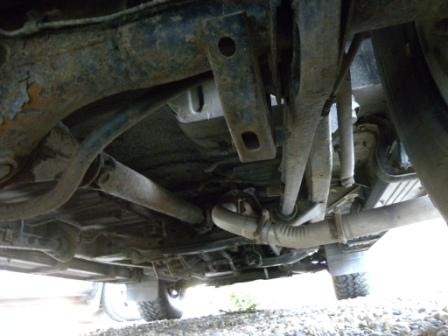

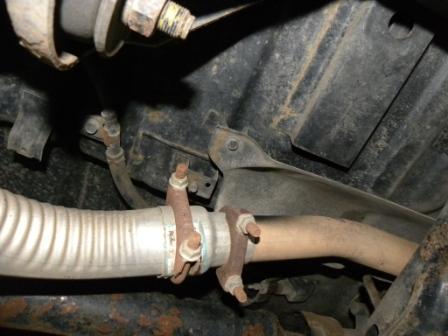

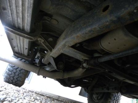

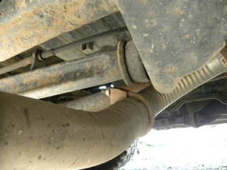

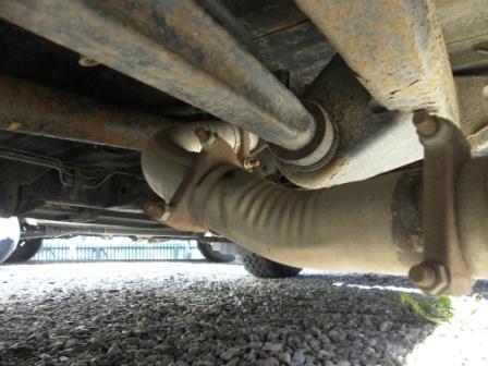

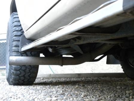

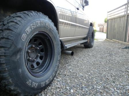

The first week i drove my 89 pj i broke the pipe just before the muffler. Went to parts source and made a side pipe and it dose sound like the dodge. Went from a 1.5 to a 2.25 pipe. I can see and hear the pipe from my drivers side mirror and window. I love it. It is only loud under load. Saying that i get a little more throttle happy. Also hear the re verb of the turbo. Hope the no back pressure dose not hurt it.
- DSCN7495.JPG (27.64 KiB) Viewed 4344 times
- DSCN7493.JPG (27.34 KiB) Viewed 4340 times
- DSCN7490.JPG (24.1 KiB) Viewed 4340 times
- DSCN7489.JPG (25.88 KiB) Viewed 4340 times
- DSCN7488.JPG (28.01 KiB) Viewed 4338 times
- DSCN7487.JPG (33.49 KiB) Viewed 4339 times
- DSCN7458.JPG (34.42 KiB) Viewed 4337 times

I've been wanting to do a side exit like that, but was hoping I could tuck it in a little better or it will get ripped off in no time. Any thoughts on emptying it in to the wheel well, but not to get in the tires way when stuffed? My only concern were the fumes comming in the cab more from under or the windows or something.

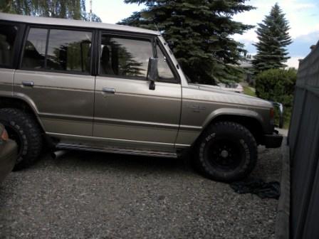

No fumes enter the cab,because it is 2.5 in beyond the running boards. You must have the pipe be equal or beyond the body line or you will get fumes in cab. Yes i considered the fact of the pipe getting riped off if i was 4x4ing, but i just play in the mud for now. It is best to run the pipe over the rear axle and shoot it out the back. As you can see my pipe is close to the bushing and stabilizer?, if you make the 1.5 pipe about 2 in shorter you could tuck it about 1 in higher and closer to the running boards. There for now in front of the rubber bushing. but closer to your leg. ouch hot. Still love the noise Just thought of this while i was taking the picks. You could bring the bend just in front of the stabilizer at a 90 degree then along the frame and then 90 it again to come out just in front of the rear wheel. I might try that so it is cleaner and tighter to the body and i wont worry about the rubber mount. Thanks for the mind jog.
- DSCN7513.JPG (30.44 KiB) Viewed 4244 times
- DSCN7512.JPG (26.64 KiB) Viewed 4241 times
- DSCN7511.JPG (31.05 KiB) Viewed 4242 times

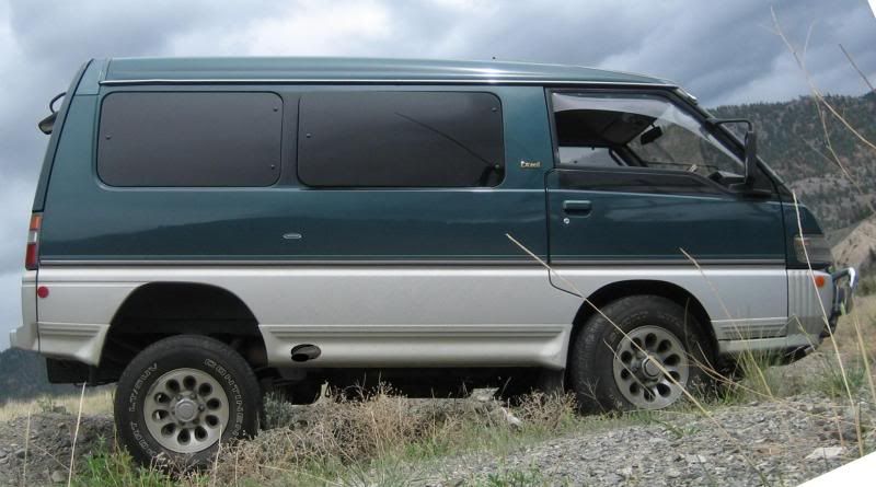

In order not to have a low lying side exhaust that could easily touch debris or curbs when parking etc. I was planning on cutting a hole into the side panel (see picture) and lead the pipe through that … my only concern with this is that the exhaust gets really hot and the lower part of the side panel is plastic… aside from the fact that the metal behind the plastic side panel would require quite extensive body work to accept a 2.25 or 2.5 inch pipe through it…. (see picture… tried to manipulate a picture of my Van to show my intention)…
