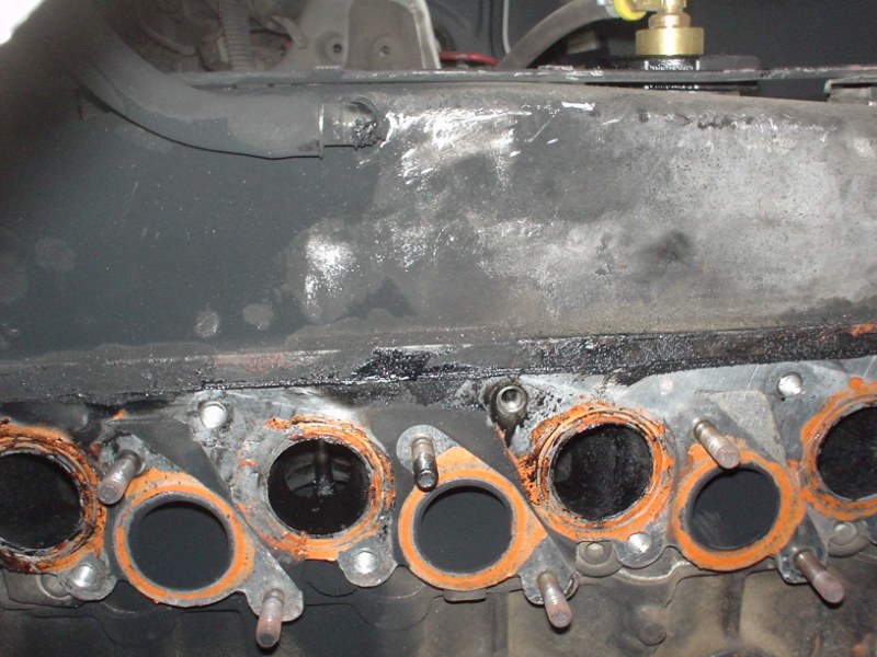

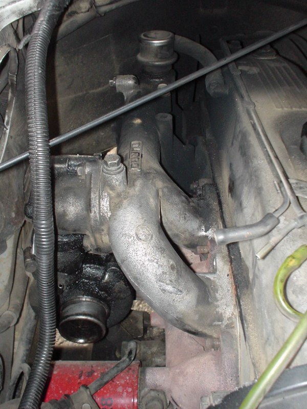

By myself, today... I removed the intake/exhaust manifold, turbo etc
had it apart and found the leak. In 2 hours. Yah, Me. Go, Me!
Then I got to looking. The turbo fins were a bit chewed up. No slack or play
but got me looking further. Then I started to play a bit. Since the manifold
was cracked with this one I transferred the newer turbo onto the old manifold.
I found that The waste gate is different. The original one has more of a 'short throw'
compared to the newer one. I used the old waste gate actuator with the new one
and had issues.. hmm Can anyone guess where I am going with this?
The old waste gate actuator wasn't opening the waste gate enough. The most
I could get out of it was 5 psi boost (give or take). So I looked over the old
turbo with a more experienced unexperienced eye (than I had before) . No slack
or play, fins look good and the oil on it was due to the output oil tube being loose.
I fixed that, cleaned it all up and I think I am good to go.

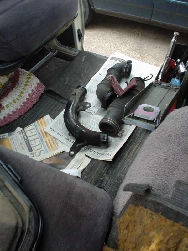

FIgured I should get this done tonight.
We pulled it over to the garage, just down from me
and I started at about 8pm. Redid, the valve cover,
filled antifreeze (drained since I redid the block heater),
Changed the oil, the frantz filter, oil filter, stuck the
manifolds back on with the turbo, tightened them up
and looked down... oops - didn't line up the oil / turbo
hose to the pan. Undid the manifold, realigned then tightened them.
It went together really slick, I took my time, and recommend
that anyone doing this replace the hose connecting the turbo to
the manifold. That short little piece shows it's teeth. And
it only costs 4$ to replace with thick, reinforced hose for
exhaust temps.
exhaust temps.

- Problems of a leaky valve cover. Although you wouldn't expect it to 'really' cause a problem oil will seep down and get into stuff. It's an easy fix. Just do it.
- DSC03790 [800x600].jpg (116.8 KiB) Viewed 2718 times
- You can see from this one I had a leak somewhere.. all that soot and crap
- DSC03788 [800x600].jpg (111.37 KiB) Viewed 2717 times
- Here are a bunch of hoses ;) (cover the manifolds)
- DSC03787 [800x600].jpg (107.93 KiB) Viewed 2718 times

On the turbo picture you can see all that oil on it.
A good portion was due to that degraded hose. Then with
just a little oil you get soot from the leak, dust and
all kinds of stuff making it really disgusting.
