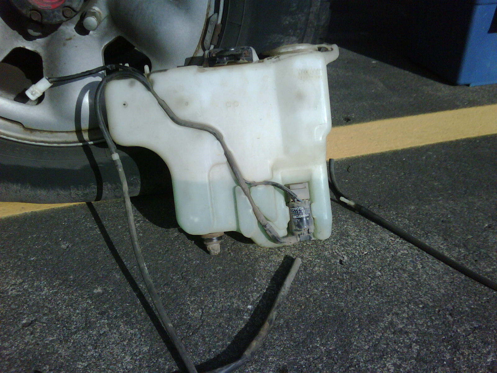

The rear "bag" washer sprayer from my 4Runner. It looks like it could mount in the engine bay in lots of places, I also found it will fit directly in front of the left wheel under the headlights in a big opening, and you can still reach the bottle to fill it through the fender, so that is an option:

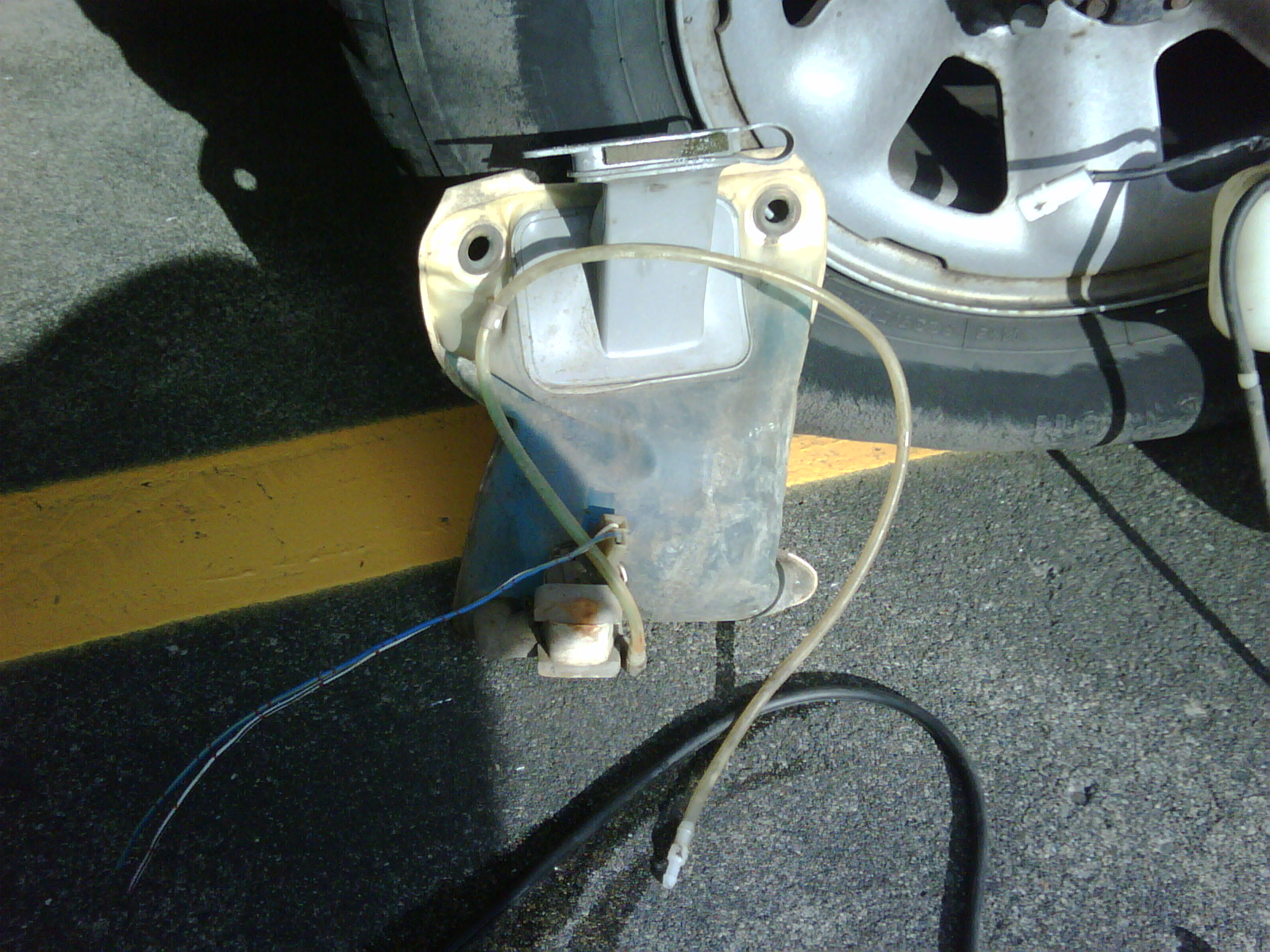

The larger capacity water bottle. Harder to mount, and harder to find a place to mount it that I can still reach it to fill it:

One thing to remember about windscreen washer bottles like the 2 pictured above. the pumps will allow all the fluid to drain if they are placed above the exit to the sprayer! The pumps don't resist the fluid coming out via a siphon! Thus, you need to mount the spray bottles blow the height of the intercooler sprayers.
