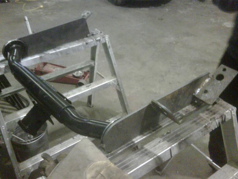

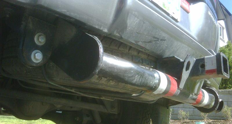

This is a hitch I made for a Delica Pick up truck
This one was for an Isuzu MU from Japan, put on Hardened Steel spiderweb chain mounts and welded a nut on to put on a bolt to stop any sway from slop in the hitch
This is clearly also before it was finished and painted, but for the frame style of the vehicle, this was the best plan for a hitch,
Im not looking to build any hitches, but I wanted to post this to give some input about how to properly build a hitch. and for a $50 hitch, you get what you pay for...
