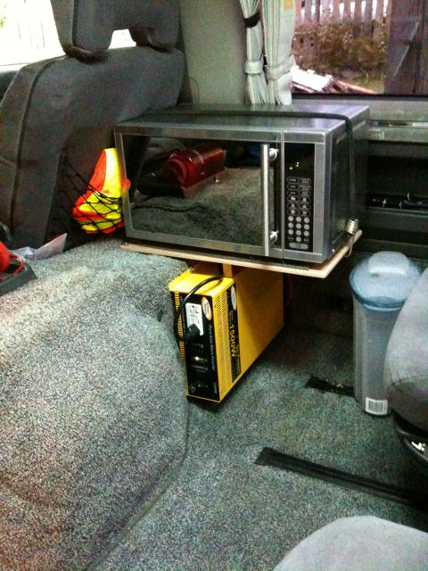

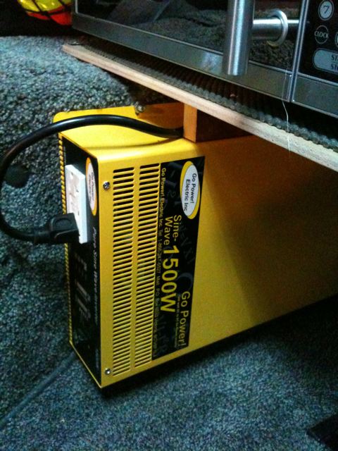

From Lordco $800......not cheap but made in Victoria by GoPower a part of Carmanah solar I think
1500 watt wired in with #2 welding cable and a 200 amp fuse , powers up a 700 watt microwave no problem.They have a good website also with lots of info on different size kits etc.

Ouch! That's the price of quality I guess.
How come you didn't put your microwave facing back instead of sideway? Seems it'd be more space efficient. Tardisdeli watch out, you no longer have the microwave exclusivity!

Its for daily use at work , I've been tired of sandwiches forever and cold leftovers leave me .......... cold.
Its easy access standing at the side door and I can do a reach around from the front, and the rare time I have a passenger in that seat , they can still keep one leg stretched beside the micro.
I'm a carpenter and I'm often at 3 or more worksites in one day.

Yes, the TardisDeli noted the microwave, and its' odd sideways installation, but is impressed by the idea of access from the front seat ... handy whilst stuck in traffic, hmm. But TardisDeli is even more impressed by the 1500 watt SINE WAVE inverter (TardisDeli is modified sine-wave, but the only thing affected by non sine-wave is that is my Christmas Lights will ONLY stay on rather than go on & off in time to the music). Hope you put a huge fuse in (Ric, I think mine is 300 amp fuse for my 1000w inverter and 500w microwave). Welcome to the Microwave World of Delica Life. Cheers, Christine.
