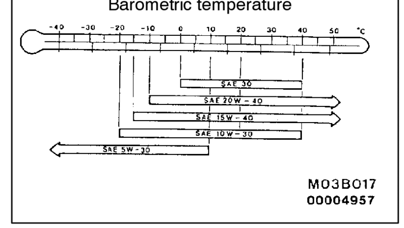

At the page 32 of http://www.delica.ca/manuals/L-400%20Ma ... 97_E12.pdf from Download and FAQ section says:
Cold climate 10W30,
Moderate climate 15W40,
Hot climate 20W40
So, are we in cold or moderate climate in BC in winter?
Cold climate 10W30,
Hot climate 20W40
Re: Oil change
Moderate to cold. Lower Mainland and the Island, moderate. The rest of BC, bloody cold. Depending on the Winter, of course.
