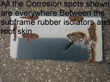

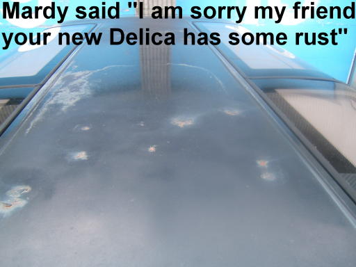

I recently Imported my second Family Delica a Beautiful L300 with only 60K on it.After what seemed like a Forever it arrived.Mardy was extremly helpful and picked it up for me at the docks.He phoned me and said nice Van my freind but your not going to like the roof..
I was hopefull in that he was over reacting.Mardy completed the Complience work (Excellent job)and phoned me to come pick it up.Once I arrived in Van He picked me up at the airport and helped me arrange insurance (Talk about excellent customer service)Unfortunatly he was not over reacting about the corrosion on the roof.After bringing it home to K town I proceeded to remove the headliner and shade mechinisms exposing the sub frame and roof skin.The corrosion appears to have started between subframe rubber isolators and roof skins and ate it way from the inside out.Then the work began.I then Drilled off the spot welds on the structural cross member fully exposing the roof skins.It was really bad...Mardy was right.I have now cut out the corroded skins and preped for new sheetmetal.A work in progress I thought I would share.I highly recomend others to pop off the head liner and check this area (Hopefully you find nothing) and then spray with rust inhibitor.I am going to check my wifes Delica as soon as I am finished this repair.
More to follow..

This issue has been identified time and time again, predominantly in the Crystal Lite roofed models. The speculation is that the 'thick' roof liner (roof liner with blind mechanisms) is trapping greater amounts of moisture and humidity, allowing for roof rot. Not always, but sometimes.
It's good that you've taken the time to remedy the situation, and it looks like you've the means to do it yourself (most are not so handy nor fortunate). Thanks for posting pictures - they'll be of great assistance to others who are looking to fix their own Delica's cancer.

Keep us posted on this one... this is what I'm facing too, I'll be doing this exact fix soon. BTW, did you have to remove any of the windowshade mechanism?
- dennis_lambert
- Posts: 321
- Location: Kelowna BC
Re: Heavy metal my new Deli.
I am hoping to assemble the first stage of repairs this week and will definetly post more Info and Pics.jwfchase wrote:Keep us posted on this one... this is what I'm facing too, I'll be doing this exact fix soon. BTW, did you have to remove any of the windowshade mechanism?
I had to remove so far the rear shade Mechinisms,Air distribution ducts and wire harness.
More to come..
Cheers.
