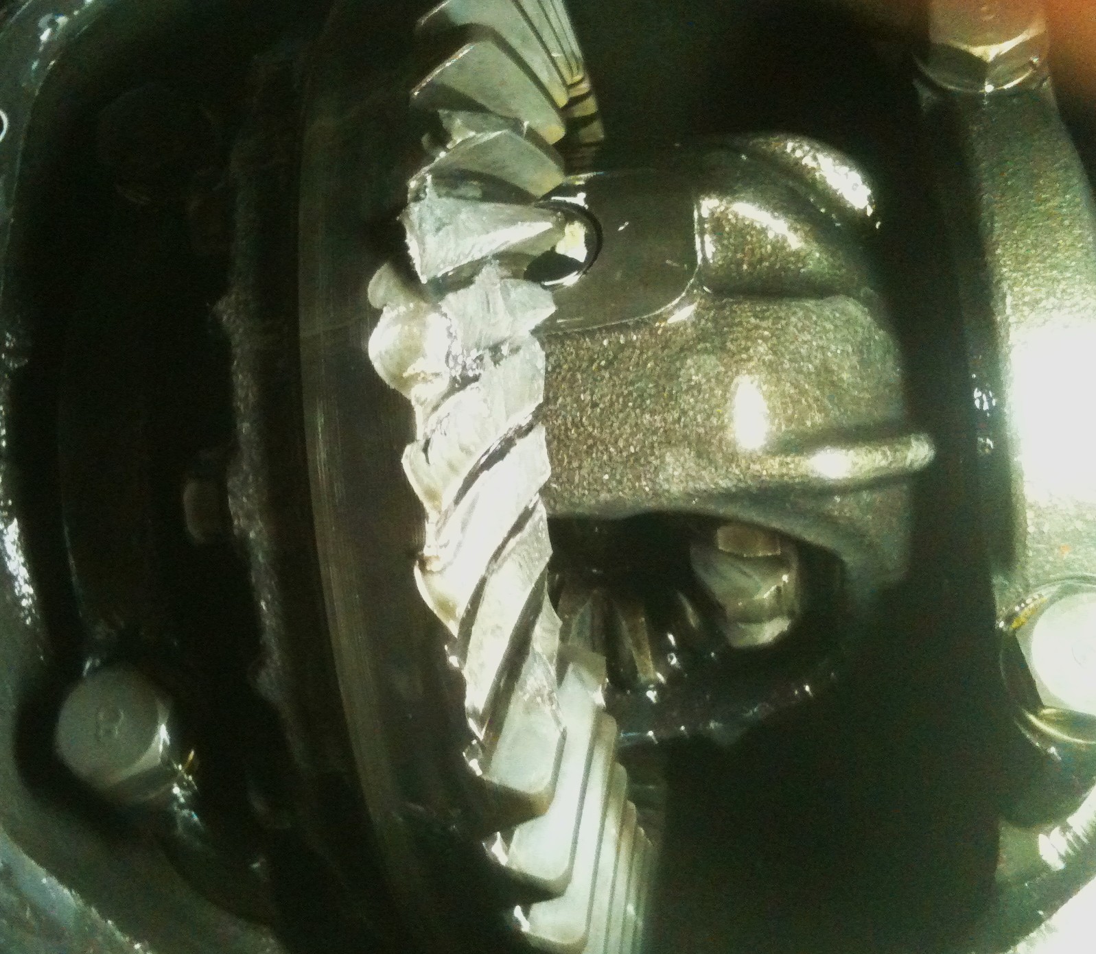

So I got a little too aggressive while trying to make it through a trail of which a portion challenged the abilities of my truck, I didn't make it through because of some casualties that met their demise while attempting said difficult portion. These innocent victims were the teeth of my ring gear in the front diff. This is what happens when you run 35" tires with a stock drivetrain and you have a heavy right foot, lol.

ouch. i guess the stock drivetrain can't handle everything we throw at it.
Re: 4x4 fun = broken parts
Good excuse to upgrade to the larger v6 front diff
It looks like you ran out of torque and when you 'punched it' something gave. Here's a description of what happened: http://www.4x4abc.com/4WD101/math_wheels.htmlstrada-caster wrote:ouch. i guess the stock drivetrain can't handle everything we throw at it.

The diff broke when I was at one section that I couldn't crawl through, hitting it at speed for the momentum wasn't enough either. The only way I could make it was at speed while maintaining full power, when the front wheels would leave the ground they would spin faster and the result when they got traction once again was the excessive torque that broke the diff, these vehicles do not have the power to break their parts under normal cicumstances even with 35s. There is almost always a reason for breaking parts on a vehicle like this, either abuse or poor installation = excessive wear. In my case if I had smaller tires I would probably have been fine, alternatively without turbo lag I could have modulated the power to lessen the impact at that time while still powering out when the front tires hit the ground again, with the turbo lag I needed to stay on boost the entire time.
