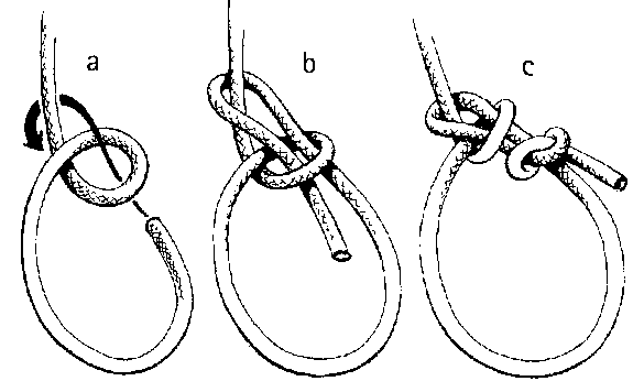

Ditto (almost) for industrial and outdoor rope rescue and confined space-- all figure 8 family of knots. For awhile they stopped teaching us the bowline for life safety applications. Now we are allowed to use it to anchor a rope around an object but it must have a backup overhand safety tied at the end:
As you can see in the picture, the running end terminates in the middle of the loop (drawing "b"). Another disadvantage of the bowline is that if you tie it incorrectly with the running end terminating on the ouside (make the bunny go the wrong way around the tree :wink: ) it looks very very close to being correct. Kenrmantle rope under load when tied this way, WILL come apart in fairly short order. The figure 8 is very easy to visually inspect once it has been dressed, it either looks right, or it's tied wrong...

AAaaahhhhhh..... I see what's happening ~ You are using the bunny to go around the tree. No wonder! I NEVER use the bunny. Bunnies are dangerous and unpredictable. I always use the snake to go around the tree, in fact I prefer the serpent.

Actually I use another method altogether, but for simplicity of illustration's sake... :-D
