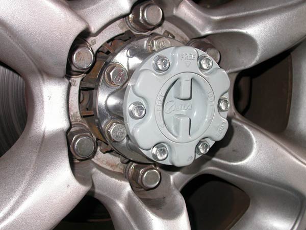

The same supplier we are going to order the snorkels from http://www.delica.ca/forum/snorkel-for- ... -7716.html has also solid manual hubs for l300s and l400s from Yijia.
I don't need hubs, but if anybody is interested I can add them to the group-buy. Depends on the quantity they are $180 plus shipping.

Looks like the exactly same die and molds of the renowned AISIN hub, cool!

Unfortunately we lost our super winch hubs when we had the van serviced, so we're on the hunt for new manual locking hubs. We haven't heard of these, would appreciate any feedback or input anyone has about them. The thing we didn't like about the super winch hubs was the allen key stripping, have heard of too many of them having to be drilled out, and now we've had that very experience (by our mechanic), we'd like to hear what folks have to say.fexlboi wrote:The same supplier we are going to order the snorkels from http://www.delica.ca/forum/snorkel-for- ... -7716.html has also solid manual hubs for l300s from Yijia.
Thanks in advance!

Dito. You strip even high-quality bits if you want to take them off after a couple years. Not a very good design of the Superwinch hubs.kb&2dogs wrote:The thing we didn't like about the super winch hubs was the allen key stripping...
I haven't heard about Yijia either, but apparently it's a common brand in Taiwan.

Had a bunch of work done on the van, including brakes. They stripped one of the hex bolts, and when they tried to drill it out they cracked the hub,so replaced them with the auto locking hubs, same as you had before on yours.mararmeisto wrote:How did you 'lose' your hubs?kb&2dogs wrote:Unfortunately we lost our super winch hubs when we had the van serviced...

Just a little industry secret....if you strip an allen head festener....Drive a slightly larger torx bit into it and you should be able to extract the fastener.kb&2dogs wrote:super winch hubs was the allen key stripping, have heard of too many of them having to be drilled out, and now we've had that very experience (by our mechanic), we'd like to hear what folks have to say.
I have never had an allen head festener that I couldn't remove this way.

L300 hubs = L400 hubs
Same shaft diameter, same spline count.
