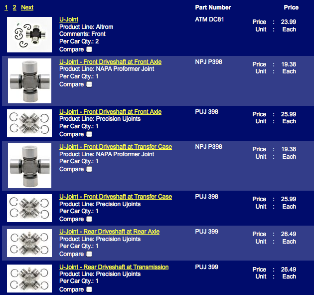

Thanks guys, any other equivalent numbers? A Les scheab is getting one in from a 92 montero. Do you think that will work? Looks like we're stranded until tomorrow.
Any numbers a us shop might recognize? Napa?

Re: U-joint part numbers needed! -shakey in Oregon
This are the parts numbers from Napa for an Montero '88
- Screen shot 2010-04-02 at 15.48.08.png (152.99 KiB) Viewed 3152 times

the precision 399 is actually a Federal Mogul /precision 399 crosses over to a Delco 45U0176, dana dt1516 and others.
You need the rear u joint for an 89 montero later years use a different part number. 89 uses the precision 399, 90 on up use a precision 450

update now that I found wifi again: success! thanks so much for the quick reply of the part numbers. I eventually found a Napa and they had a Precision 399 in stock, then I found a mechanic who stayed past his closing time to get it installed for me. Got along really well with the guys at the shop and got some advice on where to go to 4x4 in the dunes/beaches (which was very fun!).
