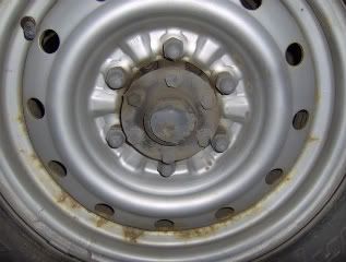

here's some pix of us on the logging road...
Yeah, it's a diesel. not gas. i know. old habit's die hard.
the wheels say "auto free hub"? I don't really know what it means for 4wd.
That old tressle sure is pretty.

Re: First time off roading... any suggestions? On Vancouver Isl
If it says "Auto Free Hub" then you don't have all-the-time-shift-on-the-fly. And if your hubs aren't "clunking" when you shift into 4WD, then that's good too. There shouldn't be a clunk, otherwise you're not doing it right or there's a bit of a problem with your ride. And your wheel lock light might be burned out or the wires are damaged on the front differential (or you might have another unique Delica - there are a couple, trust me). After this many years, we're still finding some vans with something unique from all the others.
The only thing I would recommend for the back roads, especially if you're going quite a ways in - good shoes/boots. If you don't bring anything else, at least wear footwear you can walk out in. Bring all the other stuff too, but if there's one thing I learned in the navy: clean, dry socks and shoes/boots.
