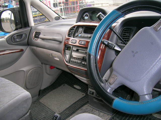

Do I have an airbag?
I was looking at one of the pictures of my Deli from Japan, and I saw this image:
Now it certainly looks like I have an airbag on that steering wheel, but there is no "SRS Airbag" lettering under the Mitsubishi symbol. There is a Japanese character off to the right on the wheel, but I have no idea what it means. On all the L400's with airbags, the steering wheel looks the same, but there is also always the "SRS Airbag" lettering as well. Does anyone know if this one has an airbag - and if not, how hard it would be to add the airbag steering wheel and sensor?Canadian living in Washington USA

Now that's a very good question, you're right, airbags say SRS airbag on them, and yours doesn't, but otherwise it is identical, but I think that's partially the point, I believe the non-airbag vehicles do look the same, but I've also been told all the royals have an airbag...
If I had to guess, I'd say you don't have an airbag.

Before we get too far off topic, wrt to inserting your own airbag arrangement, Mr. Flibble, it's generally more complicated than an accelerometer and a rapidly-inflating balloon in the steering wheel: the control unit can be tied into the accelerator, the brakes, bumper sensors, accelerometers (more than one for the different axises x-y-z), etc, etc, etc. Most airbag systems have condensor packs that last more than 10-15 minutes for secondary impacts (i.e. you've crashed at the side of the road, airbag didn't go off, but now you get hit by another vehicle) which is why a disconnected car has to sit for an hour before the technician can work on the airbag. Being an older vehicle, these systems are going to be first or second generation (read, 'simpler' than today's), but it'll still be beyond the scope of the driveway mechanic.
Short answer is: if it didn't come with one, you shouldn't/can't add one. And considering it's a Mitsubishi that wasn't sold in this market, the dealers won't put one if for you, either.
Another quick way to tell if your vehicle has an airbag is the warning on the backside of the visor: I've never seen a car with an airbag that doesn't have that warning there. Also, there should/will be an indicator on the dash to indicate the POST (power-on self-test) is correct or if there's a problem. I realise your vehicle isn't here yet, but you could look for those clues when it does arrive.

All Royal Exceed's came from the factory with an airbag in the steering wheel.
Yours is a royal exceed which means it's an airbag in there, unless it was replaced with a non-airbag version after it's inital purchase.
It can be the picture as well. The srs symbol is barely embossed in the plastic cover on the wheel.
Another indicator is the SRS symbol that lights up to the right of the speedometer
when you turn on the ignition.

Looking at mine I didn't think it is really any lighter than the mitsubishi logo... however now that you say that, and I look at the picture again, I wonder if my eyes are playing tricks on me, or if I really can see a faint "SRS" on there in the right spot... much fainter than the mitsu logo (but then again, I think someone may have accentuated that one with a ballpoint...)It can be the picture as well. The srs symbol is barely embossed in the plastic cover on the wheel.
Could you (or anyone with a non-airbag equipped L400) verify if the non-airbag steering wheels look identical (except for the "SRS Airbag" lettering?) (I suspect it does, but I haven't paid attention to the wheel of one without before)

I am guessing that it *HAD* an airbag, and probably had a non-airbag steering wheel installed afterwards. Possibly because of a minor collision. I am actually ok with this having looked at all the photos of the frame, and I cannot see any welds anywhere on the full frame. There is one small spot on a leaf spring that looks like it hit a curb or a rock - not serious - but enough that if it was whumped it could have caused the airbag to go off, and hence, get the steering wheel replaced. As long as the vehicle passes normal safety checks, this does not worry me.

You know, when I look at that picture of the steering wheel and imagine an exploding air-bag expanding at a tremendous rate.... where is that hard shell in the middle going to go? I am seeing images from James Bond movies.
