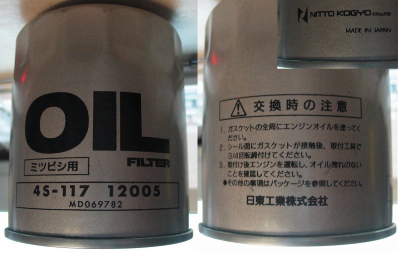

I swapped the crappy tire oil for some Castrol HDX, says it's meant for diesels with EGRs and turbos.
When I pulled the old filter off I was a bit surprised to find a Japanese one on there... what else did Karim forget to do to my van? lol

- DelicaMark
- Posts: 330
- Joined: Mon Aug 20, 2007 9:37 am
- Vehicle: L400
- Location: Duncan, BC
Re: Oil change is coming soon!
Karim had told me that he changed the oil and filter on mine too. I am pretty sure that he told me that he had new Japanese oil filters that he used. Take that for what it is worth...maybe true maybe not maybe I am remembering wrong...

- Schwa
- Posts: 480
- Vehicle: 1992 Delica Exceed
Yeah, he might very well bring a few cases of JDM parts over in every other van... My brakes still squeak, so it's a good excuse for me to pester him about that.

- Posts: 3257
my importer didn't change the oil (I hurried them quite a bit due to scheduling concerns of mine) however they did give me a brand new oil filter so I could get it done myself easily, the filter they gave me was a genuine mitsubishi filter from japan with japanese writing all over it and the box... so just because the filter is japanese doesn't mean it wasn't changed.
