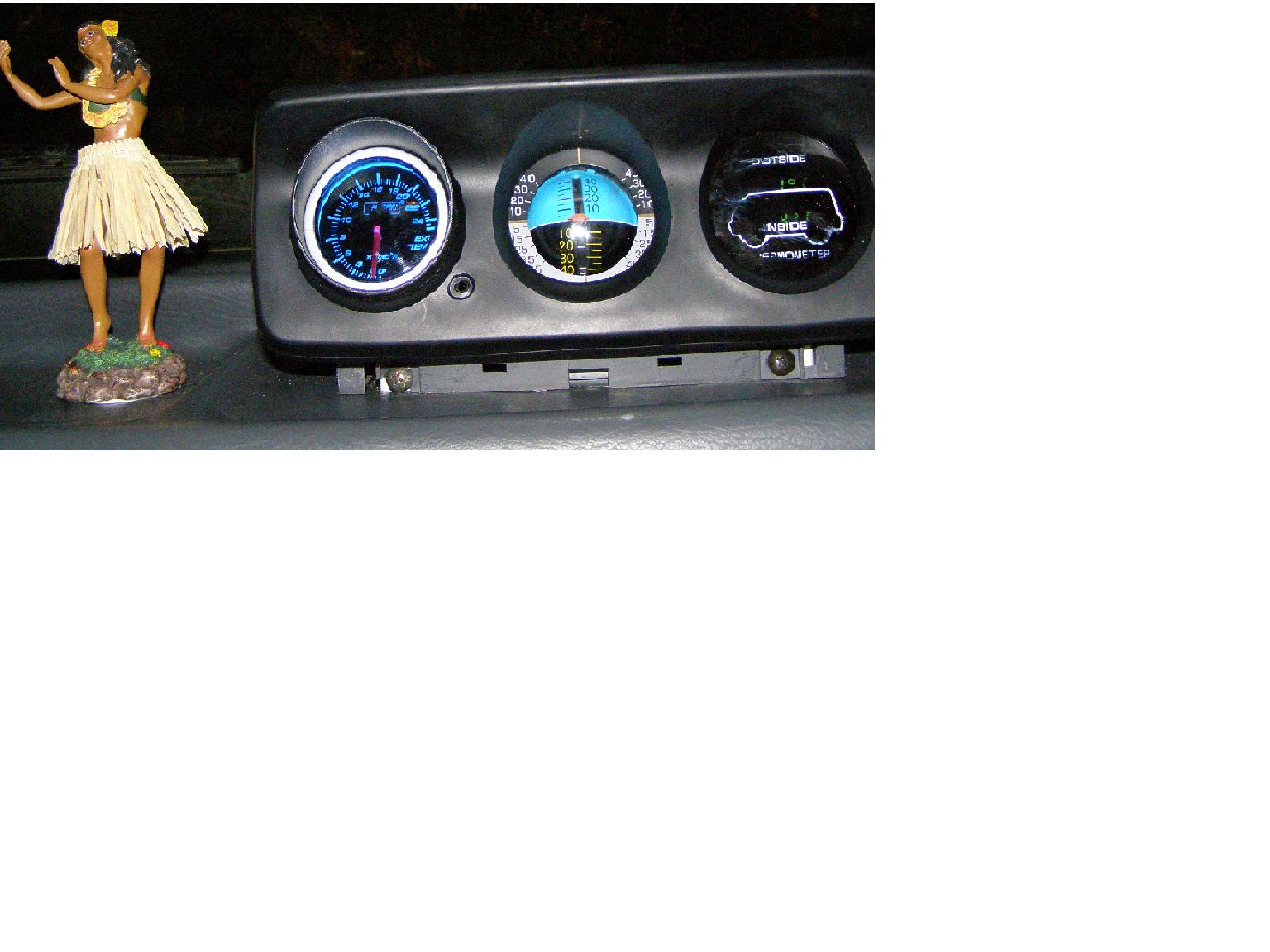

EGT GAUGE
Merry Christmas to ya all !
Just finished installing a EGT Gauge and hit 1200F up a hill.
It seems a little high....
Just wondering what sort of Temp others are seeing out there and what the Max is for a deli before you start cooking exaust valves ETC?
Cheers.
Cheers.

Re: EGT GAUGE
Nice gauge install
Can you post the specs of what you put in? I'm hoping to do the same in the next few months.

Re: EGT GAUGE
Thanks for the compliment.
The EGT Gauge is a Blue Prosport PN# 216BBFBLEGT270F.
Its range is 0-2500 Deg F.
Its OD is 2 1/16 ".It fit with a little mod into the OEM Three pod dash cluster and I spliced into the existing wiring.The Thermo couple wires were long enough to follow the original wire harness all the way to the engine....
It has a K type thermocouple and self performs a full sweep every time it powers up for cal/accuaracy...very cool.
