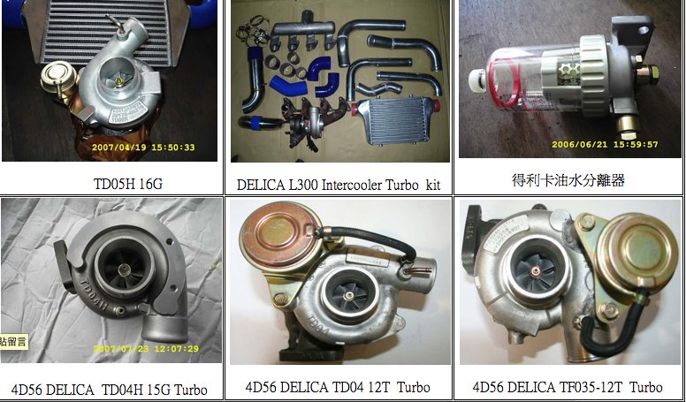

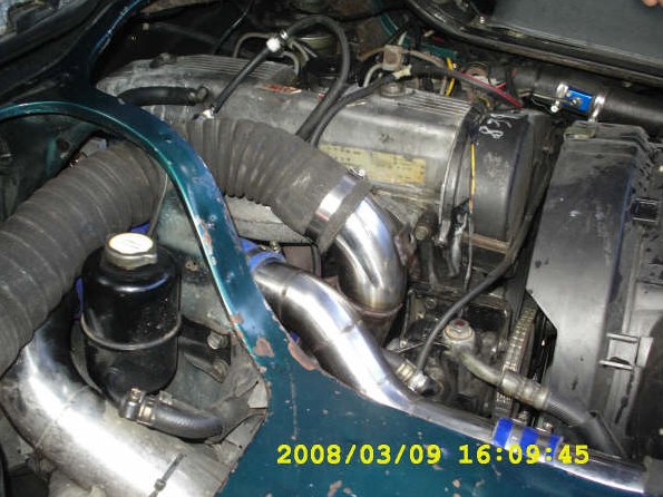

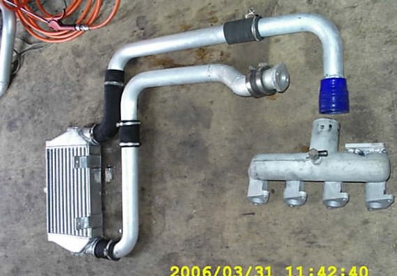

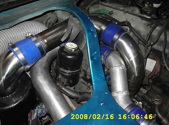

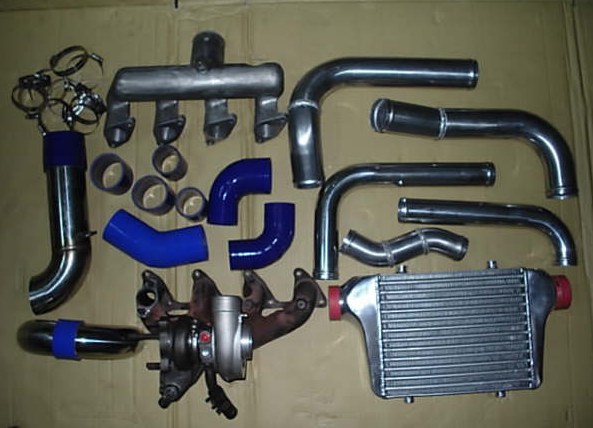

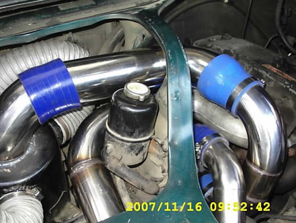

Just to answer your initial question... Yes it can be done.dennis_lambert wrote:Hi I am a new member with a L300 and was wondering if anyone has any sugestions on a improved aftermarket turbo I could install for a little more power?
I have tons of these pictures but that should give you a good idea...

David:
In your collection of intercooler pictures do you have any air/water installs?
