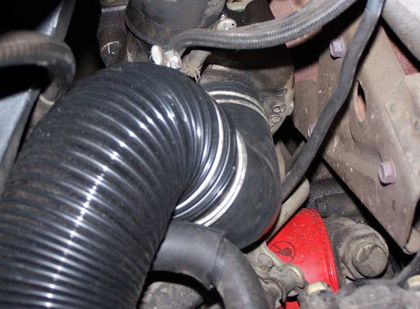

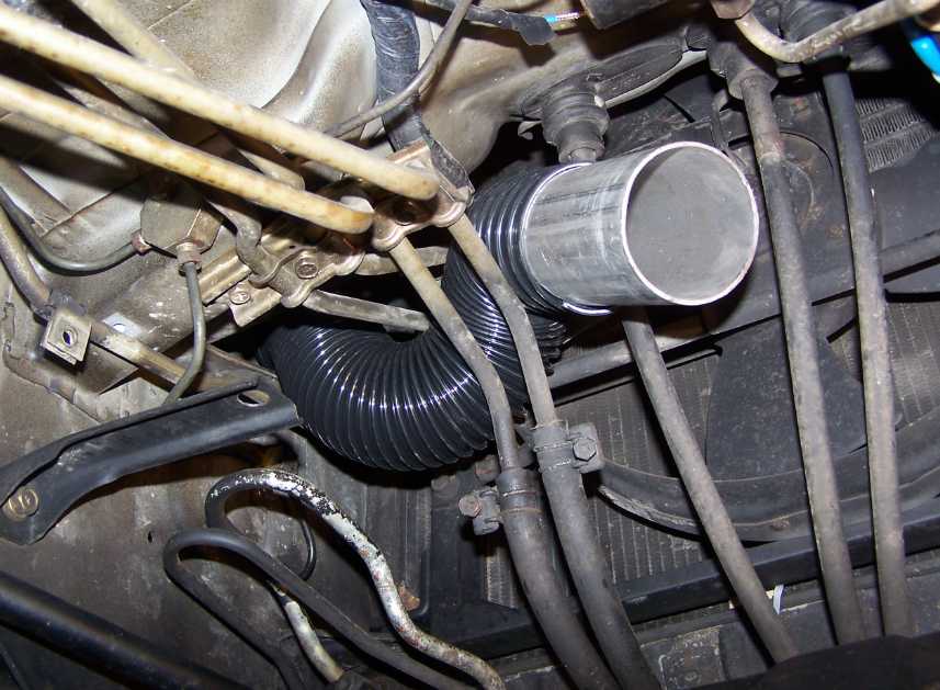

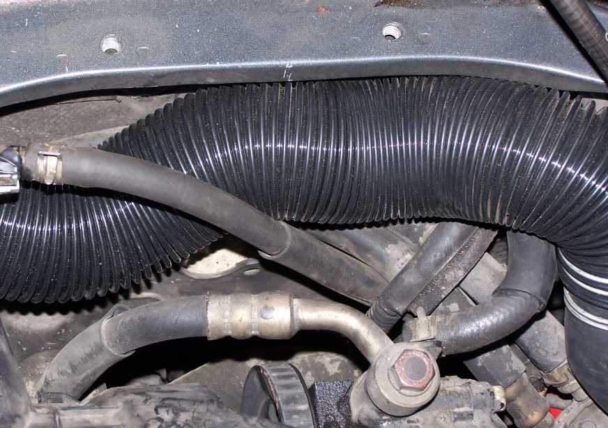

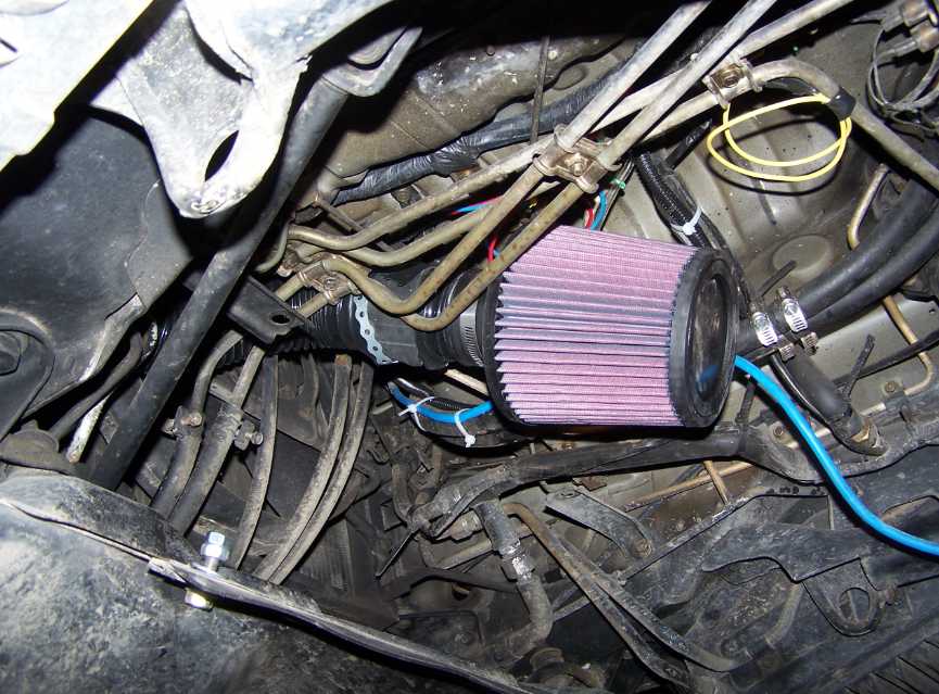

Re: Air Filter Capacity
I have finally finished the first phase of the air filter experiment. I used a K&N RU-4950 filter and 2.5” tubing from the turbo to the filter. I was able to find a 2” rad hose for connection to the turbo and a 2.5” to 2” exhaust reducer made a nice transition to the flex tubing. The routing was a little tighter than I hoped but it squeezed by the rad. The connection of flex to the filter used a short piece of 2.5” pipe left over from my exhaust upgrade. The filter is small enough all the tin protection plates and my skid plate fit back as normal. I seem to get a little more air noise than before but it really makes little difference inside the van @ highway speeds. I think the EGT is reduced but I need more time to confirm it.
I don't think the flex tubing will be a good long term solution but it works great for testing. I think a more rigid install will happen in the spring.
- Turbo Connection.jpg (51.3 KiB) Viewed 9482 times
- Flex routing Turbo to Rad.jpg (72.74 KiB) Viewed 9481 times
- Routing to cavity in front on Rad.jpg (66.94 KiB) Viewed 9477 times
- K&N Filter installed.jpg (82.55 KiB) Viewed 9483 times

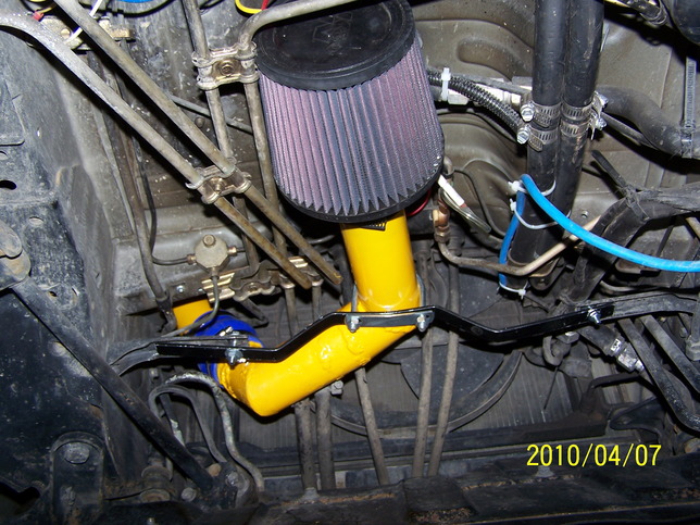

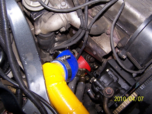

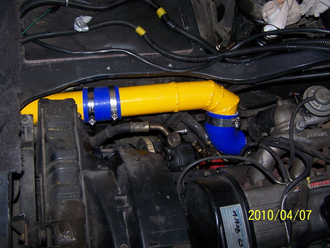

I finally completed the change from hose to all 2.5" pipe. The routing required weird bends but now it's all solid pipe.
- rsz_100_3967.jpg (150.33 KiB) Viewed 9127 times
Interesting and cool looking mod lrp374. Still not quite sure why.
The E-4810 fits perfect on a l300 '94dennis_lambert wrote:....go with the E-4810 in the original can...I just wish could find confirmation on if it will fit a 94,the k and n web page shows it only fits 87-88.
- jwfchase
- Posts: 508
- Vehicle: '92 Super Exceed
- Location: Kamloops, BC
I think I can answer some of that one. I was over visiting Larry today (nice to finally meet you in person!) to look at his project. In a nutshell, moving the air intake down into the airflow under the front of the van is giving him a similar cooler air intake effect to those of you installing snorkels. It also frees up the space where the stock filter can goes for a future project he's planning... and why not just put in a snorkel? I'll let Larry answer that one...
Thanks for the photos of the completed project!
I put a K&N on mine, but left the piping into the air plenum (instead of plumbing it forward as you have), attaching the filter there in place of the can. Even leaving it back there I noticed better 'flow' although there is an increase in engine noise without the can. I think an even better set-up would be snorkel out the side with a K&N at the top: increased water-crossing capability, better intake air flow (that can is a pretty big drag on flow), and more direct access to cooler air (out in the open instead of behind the wheelwell).
