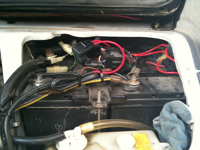

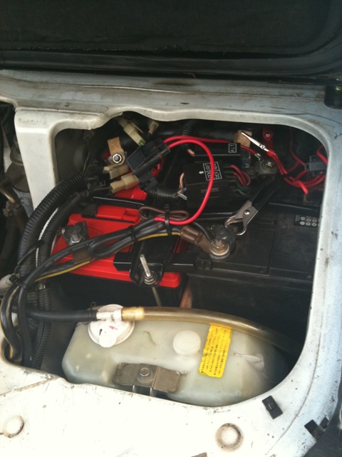

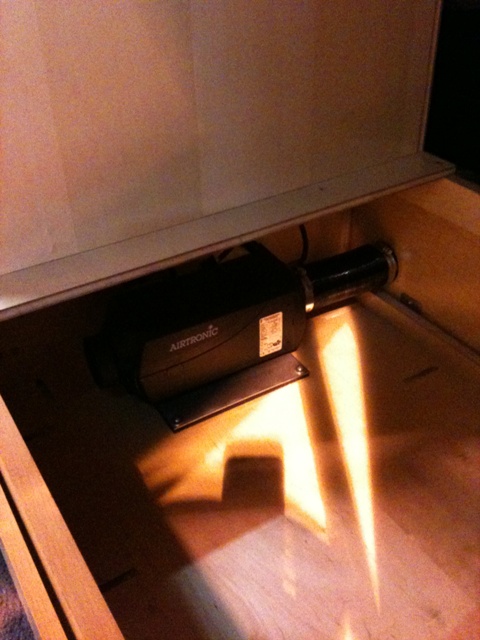

Here are my latest mods including the battery.
1) Install the Odyssey 1500.
2) Use the second battery as auxilliary use only. (solenoid install to follow)
3) Install an Airtronic diesel cabin heater. Connected to auxilliary battery.
4) Move extra toys to auxilliary battery.
- Yes there is plenty of room. Until the solenoid is installed, the auxilliary will be unorganized.

- This is the hard part. I will remove the one on the left.

- This location works pretty good. It blows low, medium, hot and turbo hot!. At turbo hot it uses 1 cup of diesel per hour. Medium will be just fine!
