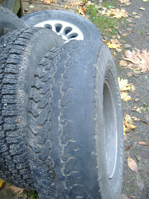

- the root of the problem. this was the tire i took off yesterday from the front passenger side :shock:
- tirebaldnesss.jpg (113.27 KiB) Viewed 5453 times

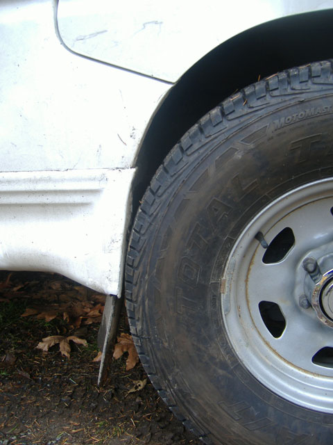

- with tire back on. there is actually more space then it looks because the mud flap is still molded to that position.
- tire-after-bang-job.jpg (44.08 KiB) Viewed 5461 times

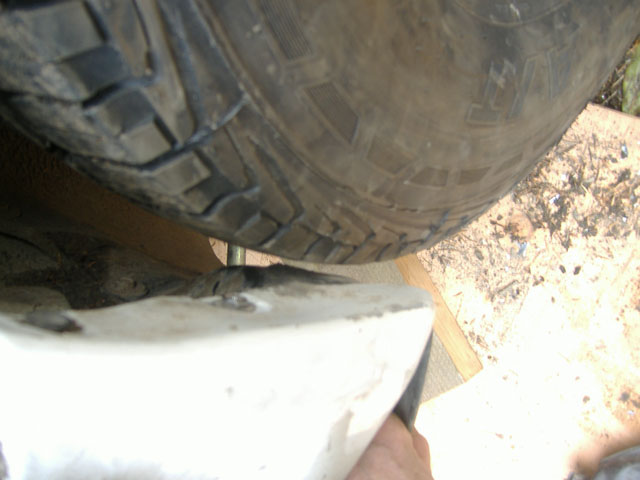

- after banging it around some
- tire-rub-3-bang-job.jpg (57.31 KiB) Viewed 5453 times

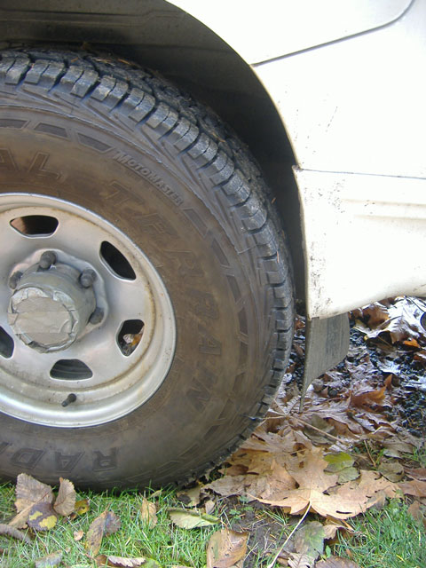

- front tire passenger side with more space.
- tire-rub-2a.jpg (82.56 KiB) Viewed 5458 times
