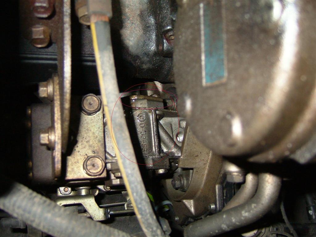

Okay, I don't know what I was smoking when I was looking at the leak
Glad I don't smoke.
Anyway it isn't antifreeze. It's diesel. It was dark.. and
I didn't try to smell it last night. This morning it looks like it's
coming from a pump? or something.
I took a picture. It seems like there is a small access panel
gasket or something and it's coming from there.
D-32-53 it says on it.
On the picture red is the unit and pink is leak.
Whatcha think... what is it? Change a gasket?
Then screw 2 bolts back in? Do I have to worry about
air in the system?
James
Glad I don't smoke.
air in the system?
James

Re: antifreeze leak nolonger... diesel leak!
I understand the frustration of leaking vehicles.
It's VERY common for the IP seals to leak.
Our sulfur diesel will cause that.
There are MANY threads about diesel leaks and 99% of them are IP seals leaking. I suggest a quick search in the future.
Possible quick fixes :
Pick up a bit of Canola oil from the supermarket and pour in a few liters on your next tank.
That may or may not revive the IP seals enough to expand and stop the diesel from seeping out.
If that does not work, then a rebuild is in order.
It's costly, mostly due to the time/labor involved.
Is it possible that it's just that cover seal?
James
James
O-rings on the sides are most common.
Too funny.
So I decided I had 2 hours to fix this.
Checked the Zexel schematic for the pump.
Found for sure that it was an actual oring not
a weird gasket.
Drove over to bearing and transmission since they
have tons of different things there.
Removed the side plate, took out the oring
and got some from B&T that matched.
Then put it back in.
No leaks.. however in my haste
At home
I realized I got turned around from looking underneath
and replaced the seal on the wrong side. LOL
<sigh>
The Zexel diagram shows the same orings are used
on both sides. This side is however, tougher to get at.
Thank goodness I don't have an auto tranny or I wouldn't
be getting in there at all. In the mean time i snugged
that side up, put some veggie oil and stop leak in to the
fuel tank and it's idling. The leak has diminished
by over 3/4 and maybe it will disappear before I fix
it tomorrow. Im thinking maybe this will be a good preventative
thing for the other notsoeasy to get at orings and seals.
Thanks for the help
James
I changed the oring on the other side.
Finally no leaks. It had pretty much stopped
itself but all in all it's good.
J
