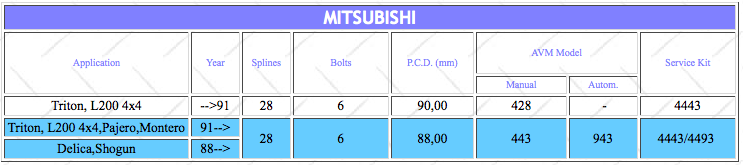

It seems their is an interest in manual hubs again so I restarted this thread. I have done some more searching on line and it appears that searching for“locking hubs” works best and that searching for a Dodge Raider provides more solutions. The brand most popular seems to be “Rugged Ridge AVM”. They are similar to the Superwinch except they have nylon center dials. One site says they still have Superwinch. Only an order would tell for sure.
I did find something of concern, however, as some sites indicate a 28 spline,6 bolt unit and others a 26 spline, 6 bolt unit. Both have the same catalog number 15001.43. I think I read they are made in Brazil using the Superwinch design.

Maybe this helps. AVM is a Brazilian company http://www.avm.com.br and they make hubs for Delicas too.
- Picture 1.PNG (475.86 KiB) Viewed 5247 times
