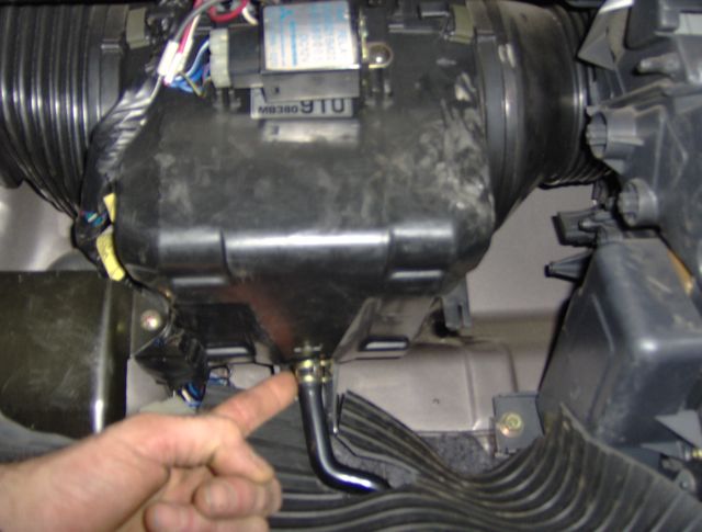

So my leaky dash issue was not the classic behind the headlights issue, nor was it the windshield seal, but rather this hose by the passenger's feet got loose. Reattached it and it's all dry again....

thanks for the heads up! i have wondered what that hose is for? my first guess is perhaps condensation from inside the cooling unit it comes from....

I figure that to be condensate from the air conditioning... it's been mentioned on the site before, but worth mentioning again (and with the picture helps too!)
