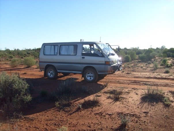

Hi everybody, its me again, thanks for all your past help, this is the quickest most knowledgeable Delica site. I'm off to Australia again prospecting 28 sep and so I need to pic your brains please.
I'd like to fit a spare wheel holder to the back door, i like the freelander 1 with the light, and wonderd if it is possible to fit 1 to my delica l300? Will it be alot of trouble? should i choose differantly?
Thanks Paul. All ideas welcome. will post lots of pics when i return.
