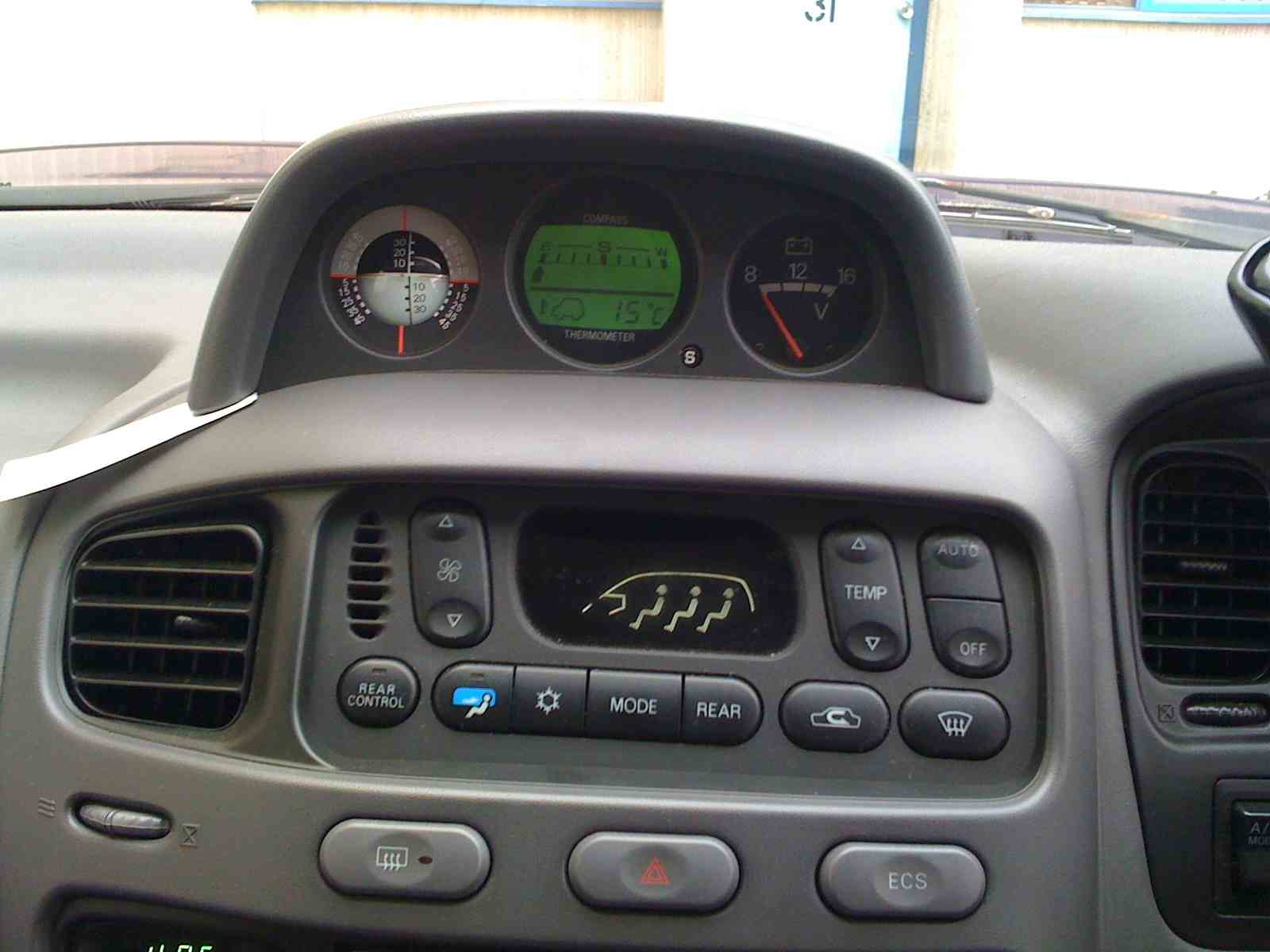

Don't know why I didn't see your post earlier (?) I do have a few questions. I tried ordering the manual from the UK but apparently I must do battle with PayPal first (buggers; leave my bank account alone...)
I have the electronic heating/AC controls. When I hit "Auto" it goes into AC mode no matter how cold it is. No problem to change it after, but is the default changeable?
The Compass/Temp gauge in the pod has a temp but what is it supposed to read? Inside? Outside? Both somehow? The "S" button seems to only reset the compass(?)
What is the button between the "Rear Control" and the AC button for? It can't be a third defroster(?) Is it for injecting blue sky directly into your head?
Which of the defroster buttons is for the front? And back?
Thanx a lot
john
Re: L400 Owner's Manual
That is, quite obviously, how you enter the blue zone... :?
Okay, I don't really know, but maybe dash vents - the arrow looks like it's pointing to the figure's head.
DeliTan wrote:I have the electronic heating/AC controls. When I hit "Auto" it goes into AC mode no matter how cold it is. No problem to change it after, but is the default changeable?
No. Auto it will go into A/C mode (defrost/cool). It's like that one most new vehicles.
DeliTan wrote:The Compass/Temp gauge in the pod has a temp but what is it supposed to read? Inside? Outside? Both somehow? The "S" button seems to only reset the compass(?)
Outside temp. (when the thermometer is outside of the vehicle (in the pic) then it's outside temp. When it's on the inside of the vehicle, then it's inside temp.)
DeliTan wrote:What is the button between the "Rear Control" and the AC button for? It can't be a third defroster(?) Is it for injecting blue sky directly into your head?
This is the cool air switch. When on it directs cool air to the upper body area from the centre vents. (press for on / press for off).
DeliTan wrote:Which of the defroster buttons is for the front? And back?
Air controls (middle console) the defrost is for the rear. Defrost beside the ECS button is for the windshield + windshield wipers (if you have them).
How do I switch it to read inside temp?
john
You can't.
On Pajero's there is a little button beside the 'S' that indicates temp. Switch from inside to outside.
I guess there really isn't a need for inside temp as the digital climate control will be quite accurate once you set it.

Looks like most the questions have been answered. The a/c coming on automaticaly is a good thing, it gives a drier air for heating and defrosting, and it prevents your a/c seals from drying out over the winter. the "blue head" button, allows you to keep your current heat settings, but blows cooler air at your face.(supposed to reduce drivers fatigue) The defroster switch on the temp. pod is for the front windshield(directs all air flow to windshield & puts fan to max) The defroster switch in line with the ECS and hazard switch is for the rear window. The switch for the electric ellement under your front wipers(if you have this option) is a rocker switch beside your automatic transmission mode switch. It has a picture of one wiper on a square window, and a small yellow light. This is to melt and prevent ice build up on your front wipers. Temperature reading is not selectable. The "S" button resets your compass and you are suposed to drive in a complete circle after pushing this button.

what is the ecs button for ???
Green1
Posts: 3257
Post by Green1 »
madmazda wrote:what is the ecs button for ???
Electronically Controlled Suspension.
