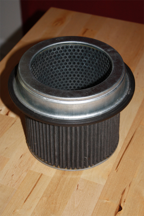

Does anyone know what will be the replacement for the air filter on the 4G64 petrol motor?
- Filter.jpg (158.25 KiB) Viewed 3174 times

I dont know the part number off hand, but I would just go into any mitsubishi dealer, or parts store, and say you need an air filter for a mitsubishi 1990 van wagon. Thats the north american counterpart. Should have one on the shelf.
I just did a quick look online and these numbers may (or may not) work.
ACDelco: ACA1215C
Fram: AHCA6389
Beck Arnley: 042-1450
NPN: W0133-1629452
Hope that helps. But really, I would just ask the guys for a van wagon air filter from 1990. Good luck.

The air filter on a 95 L400 gas 2.4 litre uses a Fram CA7142. It's 8 3/4 square by 1 5/8 inches ($13.29) w discount, oil filter PH7317 ($5.59+.55 eco fee) plus taxes. I'll add this to the wiki later.

If you want to use parts from NAPA, the following part numbers will work on a 1992 Delica Exceed petrol (or "gas" here in Canada...)
Air Filter: NAPA Gold 6265
Oil Filter: NAPA Gold 1356
Have used both and they work great!
