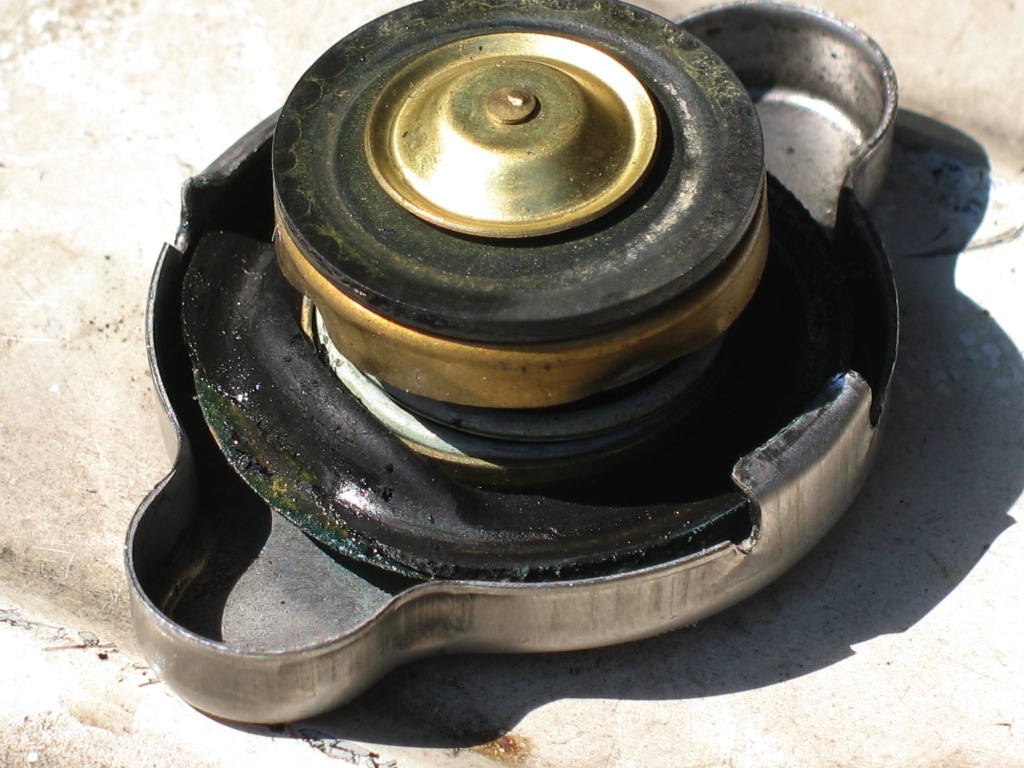

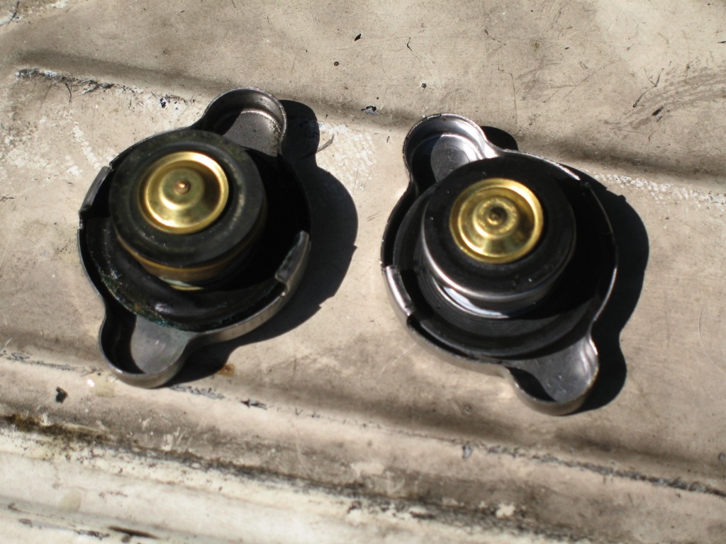

Finally, somebody did mention radiator cap, and this is what I found when I inspected mine:
Old vs. new radiator cap. Such a small item, but it can make all the difference.
See the deformed gasket? Probably not making a good seal.
