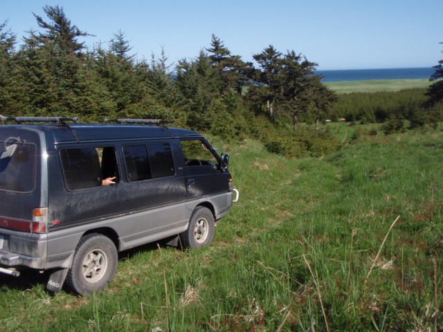

Went out on a all day 4x4 jaunt down the beach yesterday without issue. New 31x10.5 r15 tires made it a new machine....
East Beach, Haida Gwaii
....Looks like a peace sign out the window, but its two friends giving the camera the finger.
ohhhh yaaa!
Off topic,but sounds like you will be ok! :-D
Right on! 8-)
