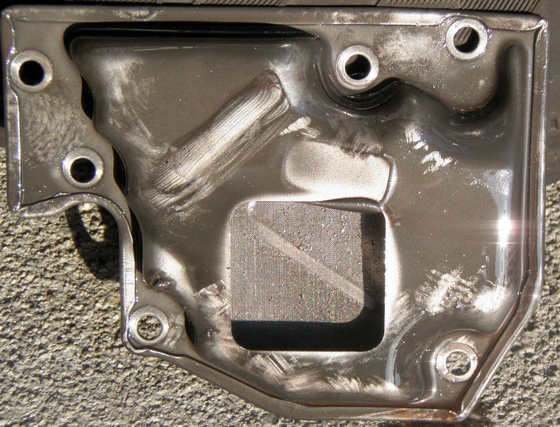

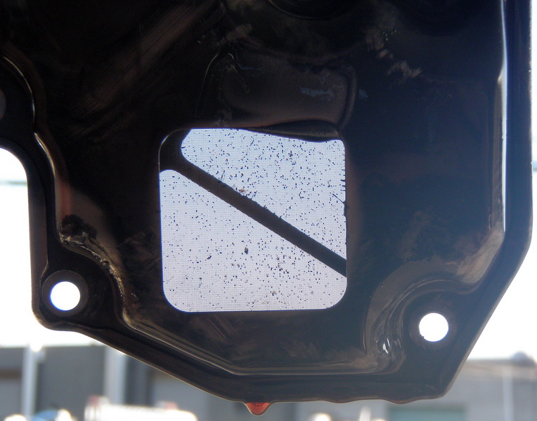

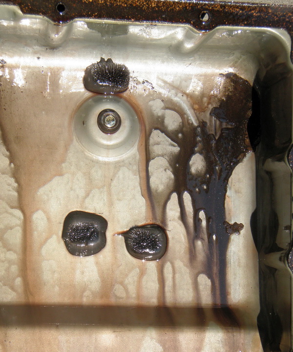

Another thread regarding an automatic transmission. The reason for my efforts was a progressively worse shifting to overdrive. Now it takes 10 minutes of driving in the morning until the tranny goes to OD. I commute for about 50 km one way every day between North Van and Langley in various traffic conditions so you can imagine that I can judge how the tranny works. Sometimes it kicks into OD as expected at 60-65 km/h while accelerating slowly and the other time it stays at 3rd gear and I have to accelerate to 80 km/h and then take the foot of the pedal and 5 seconds later the tranny goes to OD. Before paying for the replacement tranny I decided to spend a few bucks and a couple of hours this weekend to change ATF and a filter but that did not help. The pictures below represent what I saw. I am not sure if everything looked normal but I did not like the amount of 'dirt' on the magnets, the ATF color and the smell of it. The last tranny service has been done by one of our reputable mechanics less than a year and 10,000 km ago. The 'A/T Temp' light turned on twice last December while climbing to Hemlock Ski Resort and both times I stopped right away to cool down. I am still puzzled what caused the overheating; please do not advise a snow plug on the cooler. Any other input will be much appreciated.

Actually my question was simple: do the pictures represent any kind of a problem (too much dirt etc.) or not?

you cannot buy this soliniod for $40. its a diff soliniod that was inside the transmission is see it already.
soleniod price ranging fro 400-600 new. thats what my transmiission mechanic specialist told me.
as per the color its bad. that mean you havenot change the trans fluid regularly.too dirty. you much cahnge the trans filter & fluid every 20 or 25 kms.as normal usage beyound that , your looking for trouble on your transmission.
hope this help you sergie.
cheers;

Mardy - I think if you look at the original post - Sergiy mentions that the tranny fluid was changed less than 10,000km and less than one year ago.
Sergiy, the fluid not not clean for sure and the amount of material on the magnets is certainly not normal given the timing of your last fluid change. Clearly there is something more going on here with your tranny. Sadly I might be a few months behind you given my own experience recently.
