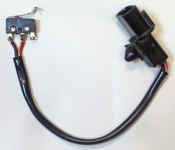

The very first issue in my Delica I had to deal with over a year ago was a tiny switch which was defective and causing the door locks go on and off while driving. As the dealer could not figure it out I had to do it myself. So if you ever see your door locks clicking on an off with no reason remove the master lock in the driver door and replace the switch. I bought it in Source but the lever was not exactly the same and I had to cut the original one and then solder it on the new switch. I am sure you can buy the right one from any other shop selling electronic parts. And of course you need a soldering iron a bit of skills.
