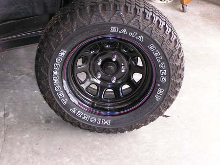

Can you take a profile picture of one of the rear tires ?
Are these what you have ?
Mickey T Baja Belted HP's ?
a bad alignment would have worn either the inner or outer rubber.
Have you ran them under inflated ?
Over inflating them would cause the inside lugs to wear prematurely. Not the other way around.

That is the exact tire, I can take more pictures if you like.jfarsang wrote:Are these what you have ?

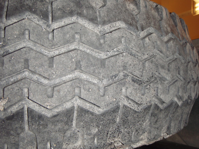

A little hard from the photo to see exactly what's going on...
Certain types of tires are prone to unusual wear patterns, for example some of the cheap lug (mud) tires that some JDM dealers like to install and Yokohama Geolanders.
As mentioned above, load is PER tire, so you add up the loads of all four to get the total capacity.

Just looking at the tire picture again...
The tire looks like it has been both seriously under-inflated and also seriously over-inflated. Scalloped edges are usually an alignment issue.
Some better photos would help.
I take it that that is a front tire?
