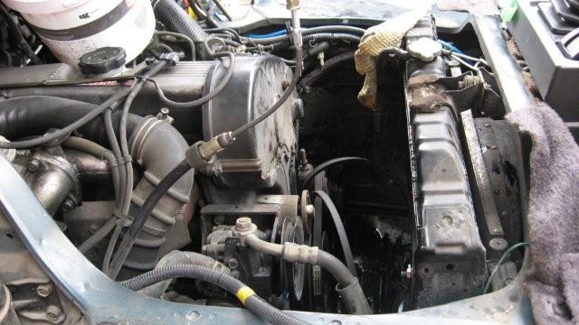

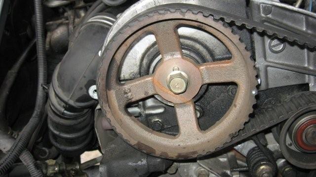

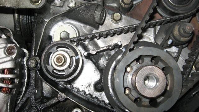

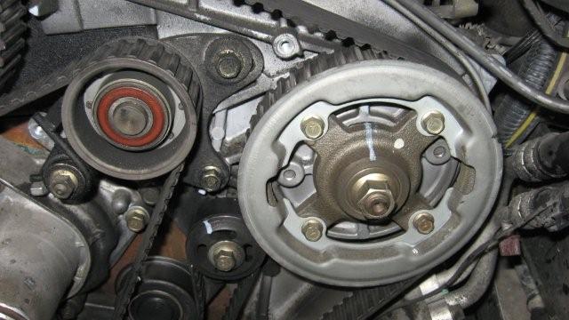

Replaced the timing belt, upper and lower tensioners, waterpump, and thermostat this past weekend. Not overly complicated, but time consuming. I have a few suggestions for anyone attempting this job.
1. Get a helper...I had one and it was invaluable. There were many times when I needed a third and fourth hand.
2. After removing the fan remove the rad. It gives you more space to work, is easy to get out and makes a big difference when attacking the crank bolt.
3. Use a paint marker to make your own reference marks in addition to those on the block (it gave me more confidence in case something moved).
4. Take a digital photo of the face of the block once the covers are off. It will help you when reassembling...especially the position of the tensioner springs.
5. Take note of the position of the bolts in the waterpump....they are different lengths and must go in the the same holes upon reassembly.
Air tools were a big help to me especially when removing the crank bolt, but are not necessary. No one should be afraid to tackle this job as it is just time consuming (8hrs). Got my parts through Sean at Zenautoworks for a good price and fast delivery. I tried to upload some photos, but couldn't do it. If anyone wants to see the face of the block before opening it up just send me an email and I will send them to you.

- IMG_1172.jpg (53.83 KiB) Viewed 7930 times
- IMG_1171.jpg (47.98 KiB) Viewed 7930 times
- IMG_1166.jpg (49.59 KiB) Viewed 7929 times
- IMG_1170.jpg (44.69 KiB) Viewed 7929 times
