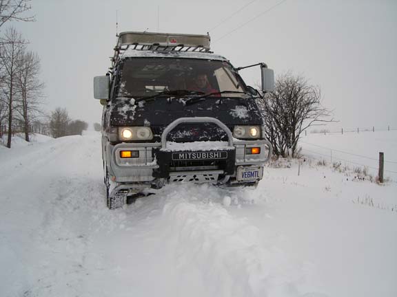

Last night we had a little snow, so the SO and I decided that required going for a drive in the countryside, down to Okotoks for brunch, then High River just because we could. The snow was deep, probably about 20 cm with the drifts being much deeper. At one point I stopped to do a photo shoot.
Front view3935.jpg (57.85 KiB) Viewed 1839 times
As you can see, ALL the cooling holes are in the snow; the diamond shaped holes are mostly decorative. A little later I noticed the engine coolant temp rise a little. So I got the snow brush out, and pulled some snow out from behind the skidplate. Fortunately, there is room at the sides to push a brush in there. Before installing the skidplate, I bolted 1/4" mesh behind the holes, so there was no way to clear the snow out of the holes. Also, keep in mind that I have a chunk of cardboard between the rad and the AC condenser, so there wouldn't have been a lot of airflow. But it was by no means overheating.

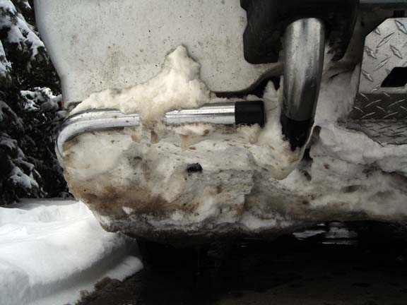

Somewhere under this snow is the transmission oil cooler.

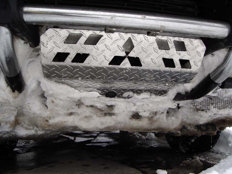

And here is the skidplate. Note that ALL the cooling holes except one is completely blocked. So for the engine to still have enough cooling at 0 Celsius with that blocked, as well as the cardboard, would suggest that hot summer days will not be an issue.
BTW, all the snow you see in the photos fell since last night at 10 PM.

Actually, I think without the skidplate it would have been worse. Filling up the scoop would cause more problem, because the AC condensor is in front of the rad, so the heat of the rad would have trouble melting the snow.
I'm actually amazed that with it completely clogged, and the cardboard behind, the engine still ran only slightly warm. Guess my rad is in better shape than many other Delicas.

To risk offending fishslapper and delicat, I would like to recommend a slight change: the last bend should be a little greater. I had to remove my fog lights that were attached to those little brackets on the back of the bambi bars because the skidplate comes too close. So I've got to find a place that can increase either the second last, or last, bend so that there is room for the foglights. But that's just me.

Hey erebus. Any fab shop in your area should be able to bend that last angle more . Just don't let them chage you more than 5-10 bucks as this should tak about 60 seconds to modify !!!
