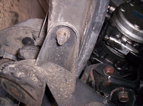

When refering to the 8 subframe bolts there are these ones (shown in the picture below) 2 on either side.
Are the other 4 the 22mm ones closer to the front (2 on either side)?

Re: Clunk!
Another clunk resolved.
Muzzy, if you didn't get a reply, the bolts you speak of are the correct ones. Two 17mm at the rear of the lower suspension arm, and two 22mm at the front of the arm. On mine van the culprits were the 17mm bolts on the driver's side.
The bolts that Christine refers to are out on the lower suspension arm near the wheel, and there are actually four of them on each side (the fourth is a little hard to see until you crawl under). I torqued these as well, but didn't get much movement out of them.
Anyway, problem solved.
