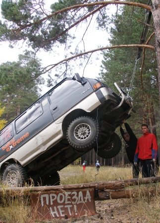

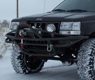

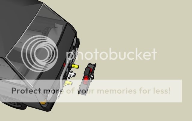

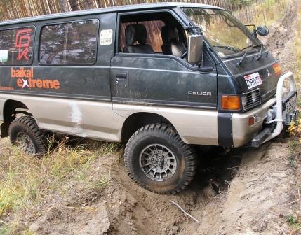

Ideas and designing input would be appreciated and more heads are better than one in this case ! :-D
http://www.delica.ca/forum/laid-off-wit ... -4770.html
Only one I've found so far about a wrap around bumper (took body corner fender panels off)

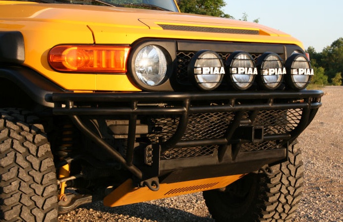

Something along these lines is what I would like to do.

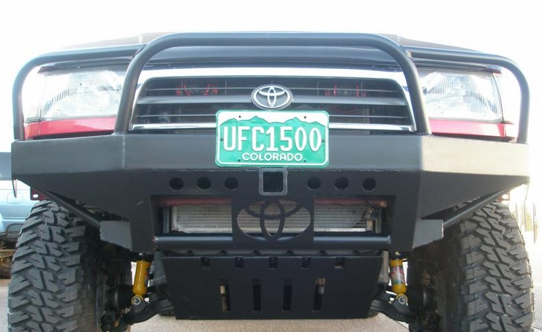

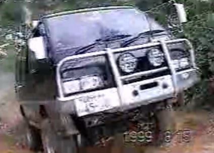

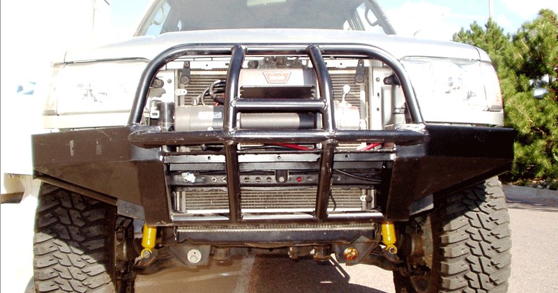

Jesse,

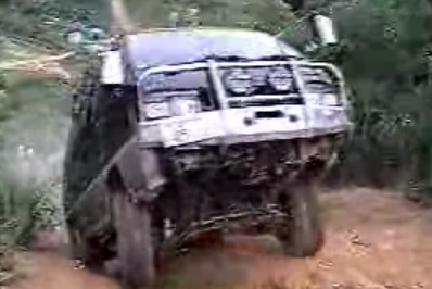

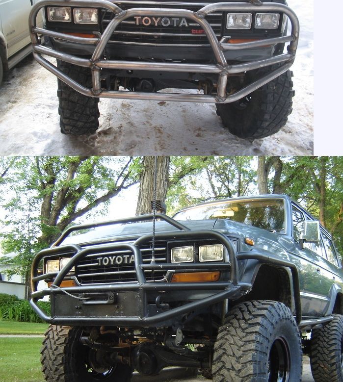

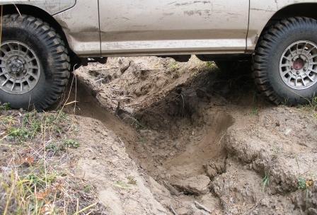

Here's a few more options. Granted, most of them aren't from a Delica but I still like how they are. It's just a starting point. The Delica pics aren't great but it's hard to find...
front bumper 6.jpg (49.9 KiB) Viewed 10567 times
front bumper 7.jpg (38.01 KiB) Viewed 10569 times
front bumper 1.jpg (92.54 KiB) Viewed 10560 times
front bumper 2.jpg (106.59 KiB) Viewed 10554 times
front bumper 3.jpg (141.86 KiB) Viewed 10543 times
front bumper 4.jpg (144.85 KiB) Viewed 10539 times
front bumper 5.jpg (37.89 KiB) Viewed 10506 times
David

Cool beans. Thnx David.
I'm going to do a few mockup designs and hand them to my eng friend and let him have a go at them.
I'll have to remove the front corner body panels, front bumper/bush bars to have him look/measure the mounting points and places to reinforce if needed.
I want to make this one a true 'cow guard' so that the bumper->frame will take the brunt of the impact *knock on wood*
Also relocating the oil/AC rads and having sloped steel plate in the corners should improve the approach angle which IMO is one thing the Delica suffers for an offroad rig.
The departure angle is nice and short. Almost like a truck going backwards :-D

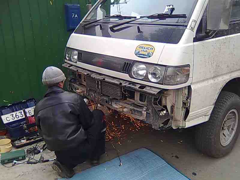

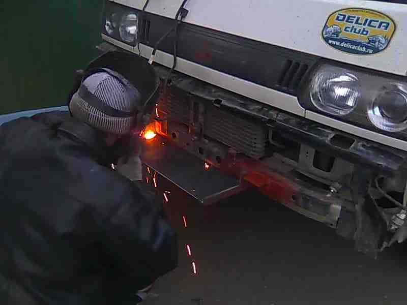

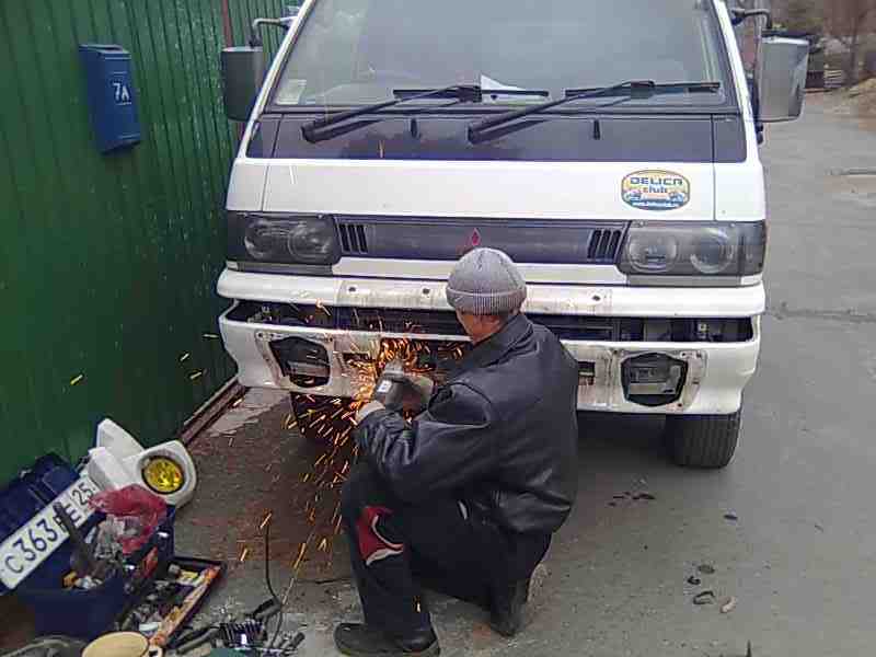

How to install the winch in your driveway.
Re: Front bumper w/ winch cradle
tsk tsk tsk ... no safety goggles while grinding.. :?
A spark on the eyeball is definitely an experience :-D

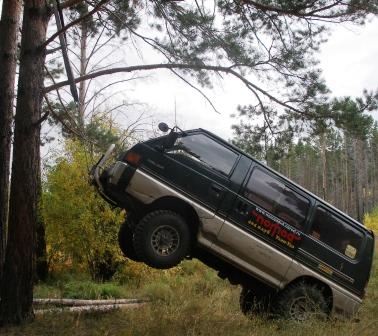

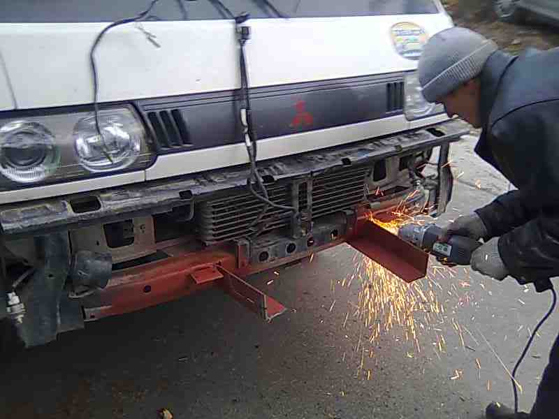

... and how to test it. The sign: NO DRIVE THROUGH!

nice winch man.
my thoughts would be to mod a trailer hitch with a duel receiver . then make a custom duel mount tray. the duel receiver would give better 'shearing strength' when pulling at an angle than the wimpy warn single tray...
then you could just move the winch from front to back.
with theft on the rise, it would be nice to be able to remove it and store it at home when using your Deli as a daily driver...
i bet it could be designed around the stock brush guard too...
al

The problem with a removable winch is weight and accessibility.
Try lugging a 100 lb winch + 20-40 lbs cradle in mud or snow let alone trying to align it.
I've been a member of overlander/portal forum for a number of years.
They have every vehicle under the sun put through things none of us would ever think of.
Out of the thousands of members and hundreds of test/users, I counted less than a handful that use a removable cradle winch system.
If I would total the amount of hours each person has with dedicated experience with this and summed it up, it would be that a removable system is great in concept but difficult to use in many conditions, let alone dangerous.
I would never pick up 120-140 lbs myself. With two people it can be done but if one slides, no shin/shoe armor, etc... it can be nasty.
I like the mockup's though. 8-) :M
