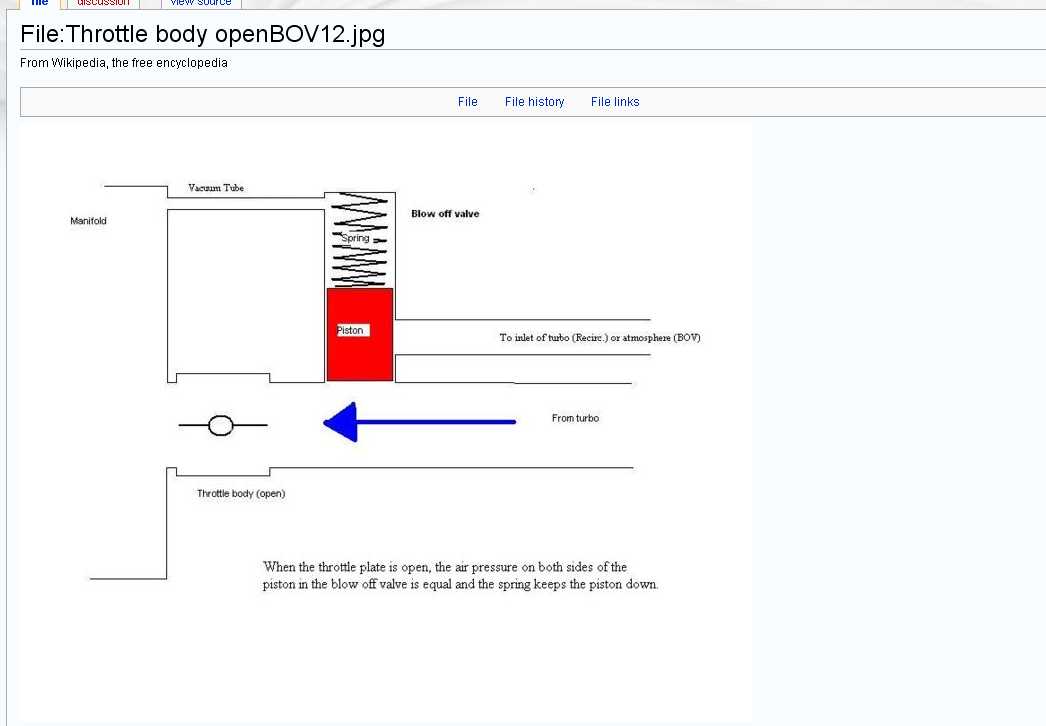

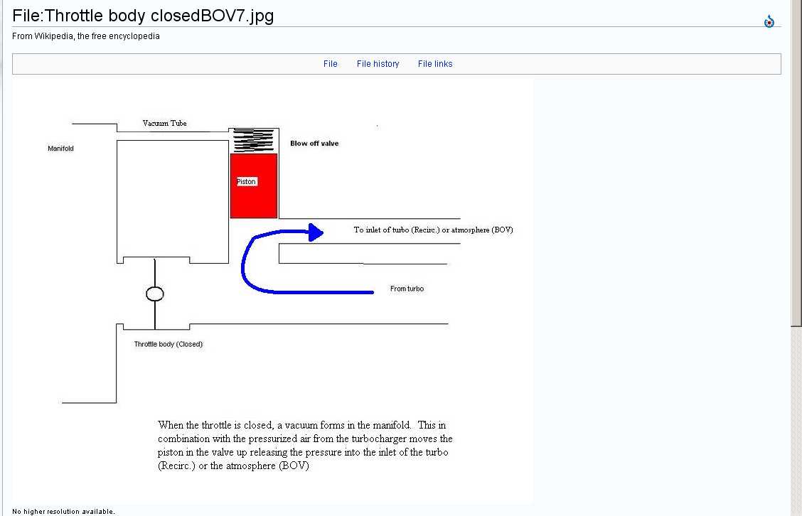

I just increased my turbo pressure this weekend and my Blow-Off valve has started to open on turbo pressure. Seems to be about 13-14 psi. I thought I'd just replace it with a higher value until I started looking @ what it's for. Now I'm confused. It sounds to me like it should operate most times you go from wide open throttle to idle. Videos of cars show them operating all the time and they even put trumpets on them so everyone knows they are blowing off. I found the attached on WIKI put I'm not sure I'm any wiser.
Have you taken yours out yet Delicat?
Larry

I'll preface the following with a bit of a disclaimer... I'm not an expert on turbos or race cars, however the following is my understanding...
Under normal circumstances the blow-off valve works as sort of a safety to prevent over-pressure, it will open if your turbo is generating more boost than you are using. On our vehicles this should be pretty rare as the turbo is only generating boost "on demand".
However, because turbos have what is known as "turbo lag", meaning that when you floor the accelerator, it takes a moment for the turbo to spin up and give you any useful boost, high performance race vehicles avoid the lag by keep the turbo spinning the whole time, as a result they are frequently generating more boost than they are using, the result is the blow-off valve is constantly being used to vent the extra boost. (if you ever watch rally sport you will hear the blow off valves constantly venting, every time they let off the accelerator)

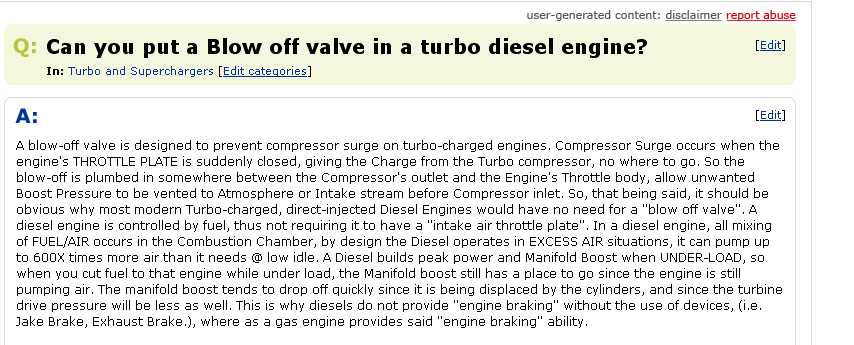

I read some more and the attached info below makes sense. The first stuff I sent really only applies to gasoline engines which have a throttle valve. Diesels do not. Now I believe that the Blow-Off is simply an overpressure device to limit turbo boost. Now all I need is a solution.
- Diesel Blow off.jpg (70.58 KiB) Viewed 5396 times

Well... the article misses 2 key points...
1) our diesels DO have a blow-off valve.
2) every diesel I have ever seen provides immensely more engine brakeing than the equivelant gasoline vehicle.

Ok, turns out our Delica don't have a blow-off valve. What they have is a pop-off valve! Confused?
Green1 explained it quite well:
So I'll have to take mine apart and see how it works (replace with a stronger spring or replace with a used unit).
D.
And the above doesn't apply to us. What we have is a simple safety valve (which is common on diesel engine) that will release the pressure if the boost becomes too high for whatever reason. I called a few Diesel Performance shop and that's what I got from them and NO, they didn't have replacement unit for our application.Green1 wrote:However, because turbos have what is known as "turbo lag", meaning that when you floor the accelerator, it takes a moment for the turbo to spin up and give you any useful boost, high performance race vehicles avoid the lag by keep the turbo spinning the whole time, as a result they are frequently generating more boost than they are using, the result is the blow-off valve is constantly being used to vent the extra boost. (if you ever watch rally sport you will hear the blow off valves constantly venting, every time they let off the accelerator)
D.
