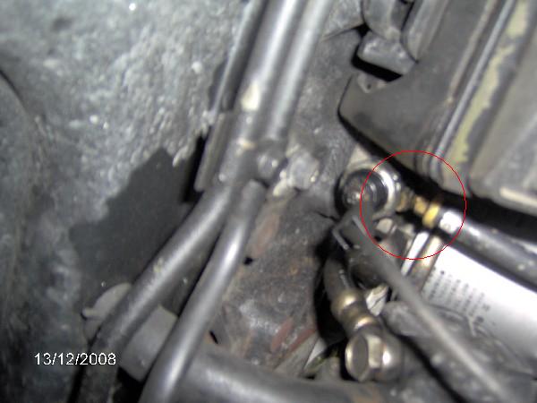

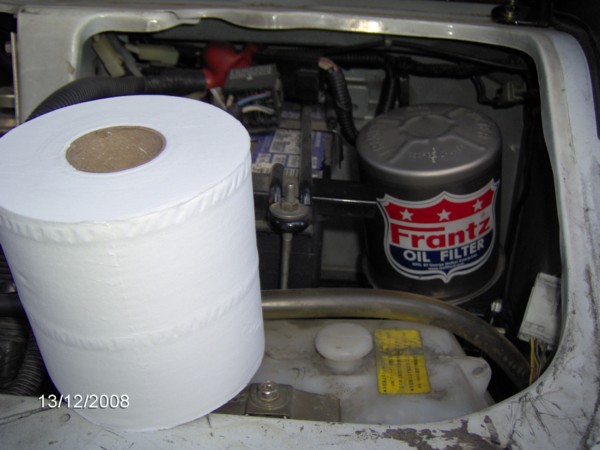

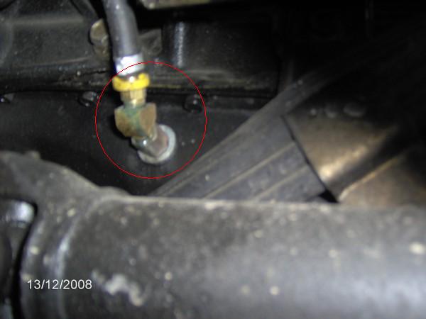

Hey Fishtank, don't know if you ever got your filter installed, but here's some pics of what I did and it seems to be working well for me. It took longer to change the battery and mount the filter than it did to run the lines. I think an hour and a half all total would get it installed. Another note is that the frantz kit came with NO extra hose. 2 " shorter and it wouldn't have been enough. The supply line runs out of the battery compartment across the front of the motor and down the other side. The return line runs out of the battery compartment and down to the oil pan.
This pic shows where the supply line is tee'd in above the oil pressure sending unit.  The fancy little tee, along with all the fittings & hose I needed came with the kit.  If you're unsure of where this is located it is right below your oil filter.  You can see my silver filter in the picture.

This where the oil returns back to the oil pan. The kit came with a little punch to make a hole in the side of the pan and a self tapping fitting.  Very slick set up.  I kept it high to keep it protected not that I do any off roading.  My van is a urban cruiser that doesn't often see dust let alone mud.

Here is a pic showing where I mounted the filter itself.  I only have the single battery so I changed the orientation and mounted the filter beside it.  There's a new "filter" sitting there too.  So far it seems to be removing the "crap" out of the oil.  Have changed the filter a couple of times since installation.
