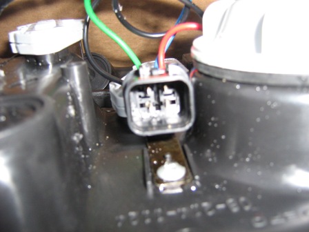

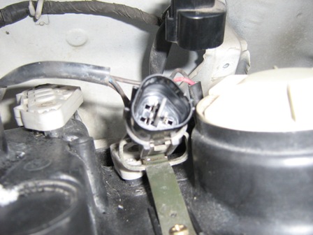

What gives? The old lights have a three prong connection and the new depo has a four. Dont tell me I got a whole lotta electrical messin round' ?
P.S. I am using "Sylvania Silverstars" H1 and H3, both 55w each. 100w is overkill and probably illegal.
- Four prongs
- IMG_0339.jpg (38.84 KiB) Viewed 6431 times
- Three prongs
- IMG_0338.jpg (44.16 KiB) Viewed 6429 times

Yes, you do. If you remember, I showed you that little detail when you visited me a while ago. I would recommend that you leave the vehicle connector alone. Cut the 3-prong triangular connecter off the old headlights (leave enough wire), cut the 4-prong square connector off the new headlights, and solder the 3-prong onto the wires. Make sure you solder them, and tape them well.
Oh, on the 4-prong connector is it actually 4 prongs? Do all 4 have wires coming out? 'Cause on mine, there were only 3 contacts and 3 wires in the thing. If you have 4, you probably have headlights with an additional socket that can be used for daytime running light (DRLs). If so, I would reverse my advice above and use the square connectors.
Feel free to phone me and we can discuss and/or meet to have a look.
- Posts: 3257
Re: Depo headlights
That's normal, the LHD headlights use a different connector than the RHD headlights, (probably to stop people from using the "wrong" ones)White Mule wrote:What gives? The old lights have a three prong connection and the new depo has a four. Dont tell me I got a whole lotta electrical messin round' ?
You'll have to cut the connector off your old ones and solder it on to the new ones, just pay attention to which wire goes where.

Re: Depo headlights
Yes Fred I have the fourth green wire which is the DRL. Even with a new four prong connector, there are only three wires coming from the vehicle?White Mule wrote:If you have 4, you probably have headlights with an additional socket that can be used for daytime running light (DRLs). If so, I would reverse my advice above and use the square connectors.
DRL 5w bulb? (plastic reads "W5W")

- Posts: 3257
Re: Depo headlights
it is NOT for DRL, it is what they call in europe "city light", I'm not sure what purpose it could possibly have, but unless it is night time you can barely tell it's there.DRL 5w bulb? (plastic reads "W5W")
