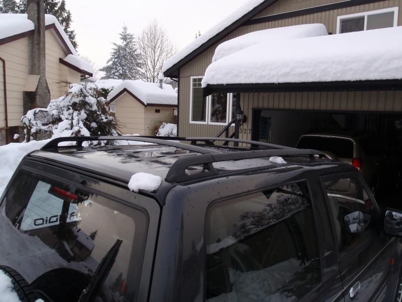

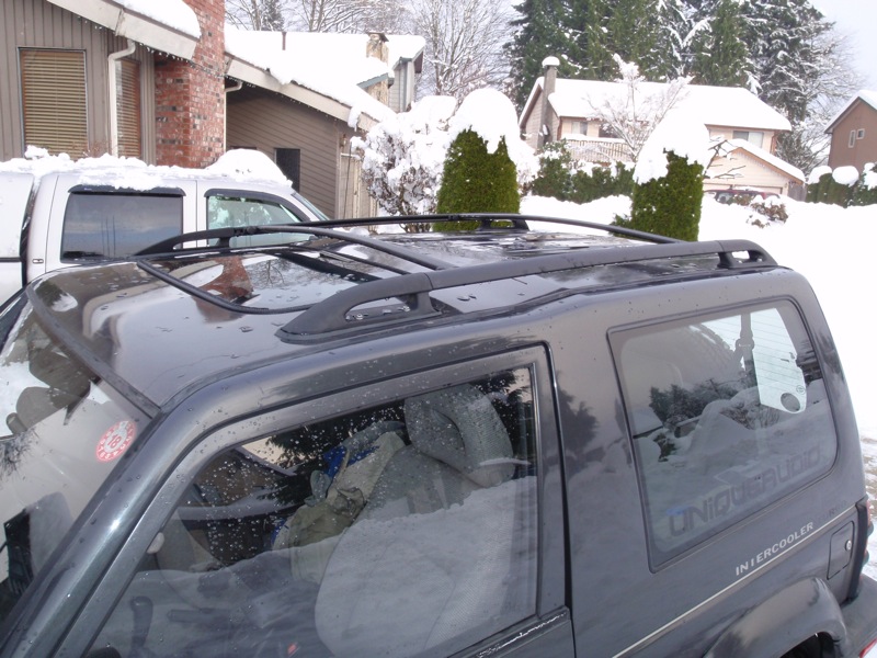

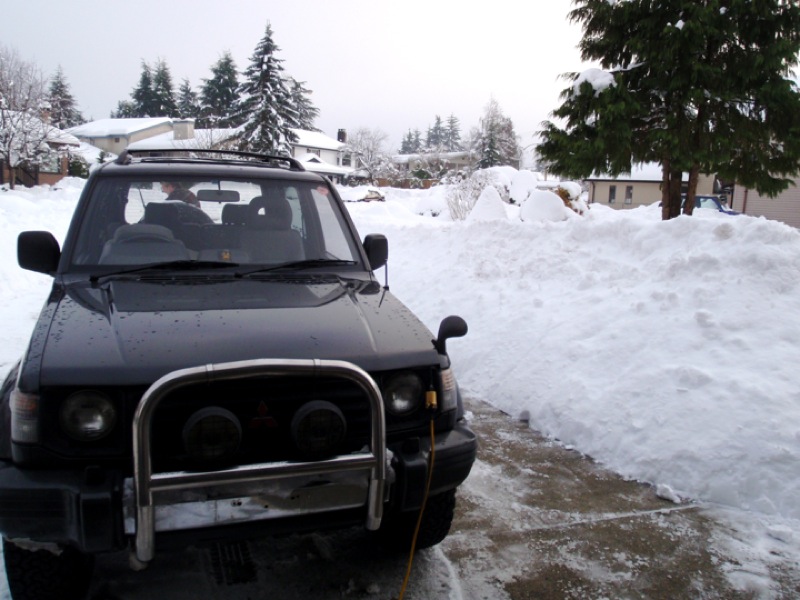

Well IT's CHRISTMAS!!! and i got the camera i was hoping for!! (Olympus.. Its shockproof, dust proof, waterproof AKA OFFROADING-PROOF!!!)
so i figured i'd test it out on my roof rack that i installed the other day
it went really well and turned out great!! here it is
i got ten (rubber sealing style) nutserts from lordco for $10.60
and ten Stainless bolts and washers from Home Depot for about $6
(bought 10 of everything for spares but only needed 8 sets)
