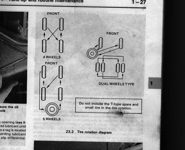

OK, I know how the tires rotate when you're only rotating 4. But I want to include the spare in the rotation sequence, because it's brand new as well. How does a five tire rotation pattern work?

A wise choice Pinkfingers! Here's the pattern I got from my nissan maunal...

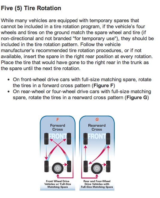

Here you go, follow the 2nd picture... From tirerack site

I've always done the rear-cross (delicat's and konadog's images) on all of my vehicles (they've all been awd/4x4's).
That is the best way to rotate in a 5th or 6th wheel.
