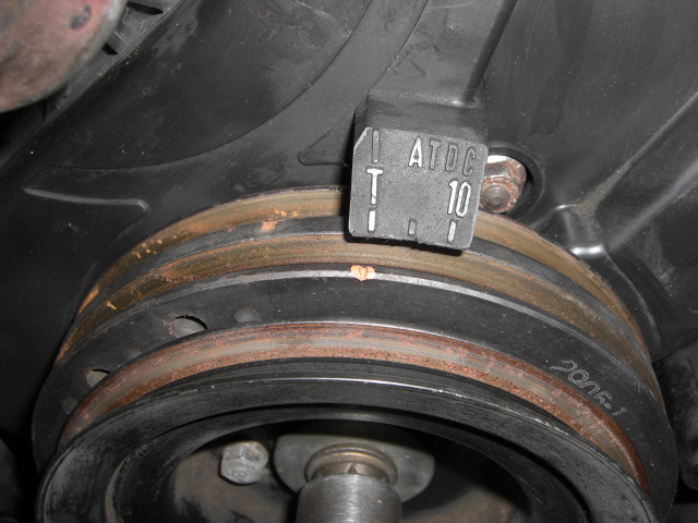

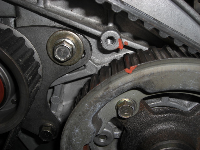

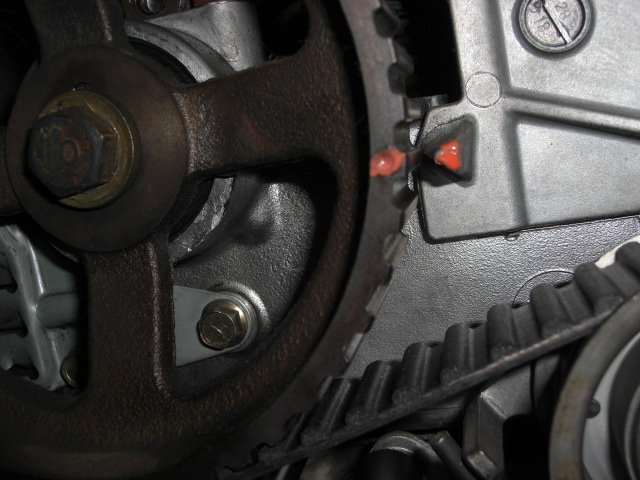

so i have figured out the timing belt and have that on, but alas i am unclear about the rocker bar? any advice would be appreciated. thanks
neil
neil
- timing belt marking 3.JPG (145.51 KiB) Viewed 3913 times
- Timing belt marking 1.JPG (135.6 KiB) Viewed 3863 times
- timing belt markin 2.JPG (132.08 KiB) Viewed 3833 times
