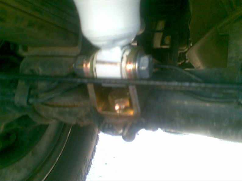

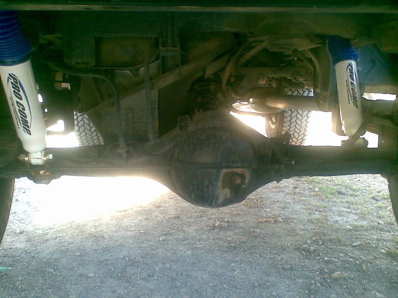

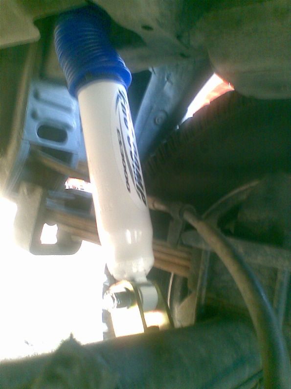

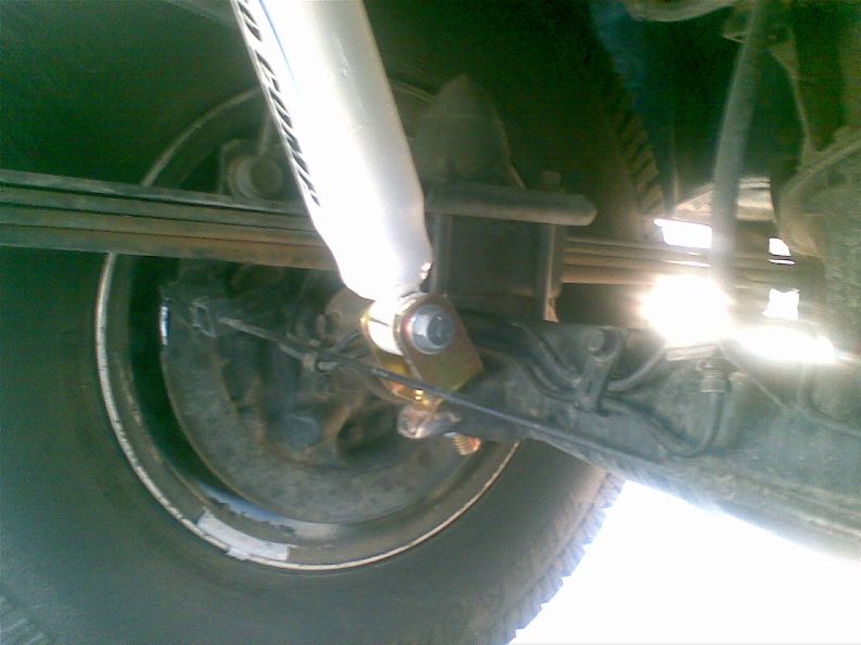

jfarsang wrote:Redid my suspension and a few tidbits regarding the lift tonight.
SHOCKS
What I had put on when I got Granola :
Procomp ES9000 (gas charged)
Front: 913515
Rear: 919520
What I replaced them with :
Procomp ES3000 (hydraulic)
Front: 315515 (2" longer stroke)
Rear: 319500 (same length except eye top & bottom)
For the rear I added 2" pin -> eye conversion blocks to use with new eye top/bottom shocks giving the extra 2" inches of travel I needed for my lift.
- -000.jpg (57.49 KiB) Viewed 4522 times
- -001.jpg (38.02 KiB) Viewed 4520 times
- -002.jpg (53.14 KiB) Viewed 4537 times
- -003.jpg (78.97 KiB) Viewed 4519 times
