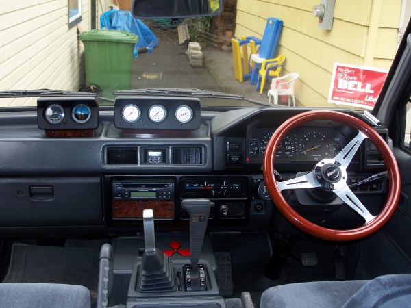

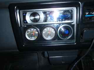

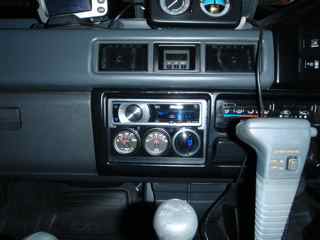

autometer oil pressure, boost and pyro. i got the 3 guage pod from a van japanoid parted out (i think)
Re: Pyro and Boost gauge - what kind and where did you mount 'em
Garyo, great to see you back on line!
That set up looks really sharp. I'd be happy with the 3 pods gauge on it's own... it's been on my to do list for a while but all in good time! Was the fit pretty straight forward for the gauges in the pod or did it need some trimming? And what are you hiding above your hand throttle? Time to rest those bikes for a bit and start playing on the Delica again! See ya soon!

garyo, that set up looks great! I always wondered how aftermarket gauges would look in a pod like that. What size Autometer gauges did you go with? 2 1/16" (52.4mm)?

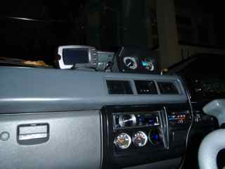

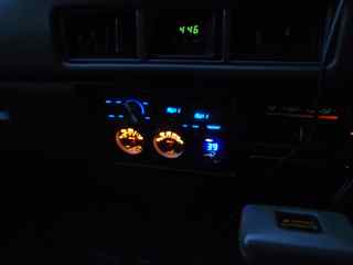

More pyrometer shots..
Also added a volt gauge and an oil pressure gauge.
The digital gauge is a glow shift boost and pryrometer combo gauge. The outer ring dislapys a pie shaped bar graph and the inner section is digital.
On the pyrometer usage seeing that i am shure that not all members will be familiar wth the device.
It is simply the best way to tell how hard the engine is working, as it measuers the exhaust gas temperature.
The higher the temp of the exhaust gas the more work the engine is doing... or almost.. as with any turbo engine a sweet spot will be achived with boost pressure. Lack of Rpm .. and there for boost will cause the engine to lug and at that point it is posible to overwork the engine and have excessivly high pyrometer temperatures.
Excessive pyrometer temps can result is burnt exhaust valves and warped cylinder heads.
In BC with our old vans this can be a real problem as lost of our highways have significant grades!
So when you have high pyrometer temperatures either down shift or if you already have downshifted back off on the throttle.
On our engines i think the max pyro temp should be around 1250F. As that is what we set the alarms on the ships at.. Maby Glen or Mardy can chime in to tell us the absolute max.
