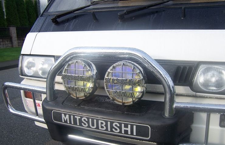

I opted for a set of KC Black Daylighter ( $109.00 at Shucks in the states) and am in the process of mounting them up between the uprights on the bullbar. NOT for road use as thse puppies will cook a chicken from 3 feet away. I got them for my jaunts in the backroads. My son gave me a set of those Cambodian Tire purchased oval ones that I had planned on mounting on either the down pipes on the insides of the bull bar or just infront of the tranny and A/C coolers. They should be low enough to cut thru some of the fog , and as for being guarded from getting hit, the spot right infront of the coolers may be a better choice. Curious to see what you come up with.
Gregg
Re: Fog/Aux Light suggestions?
New fog lights.jpg (67.08 KiB) Viewed 4782 times
