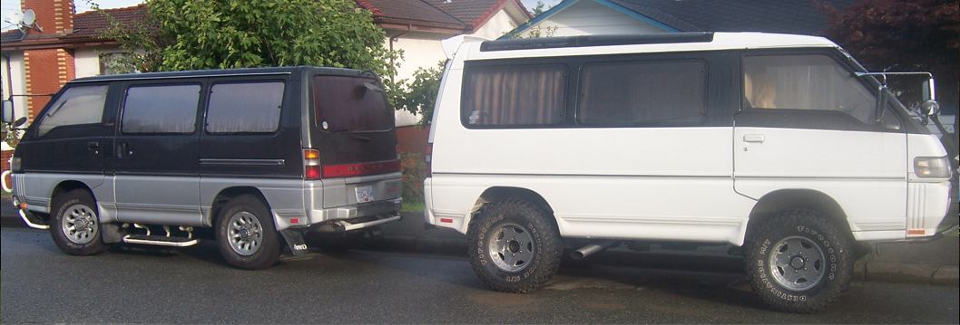

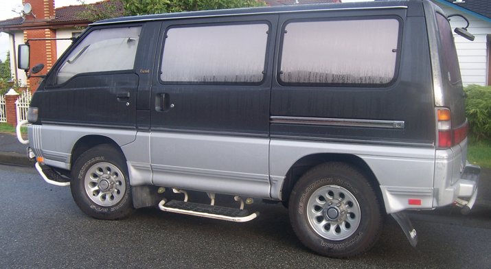

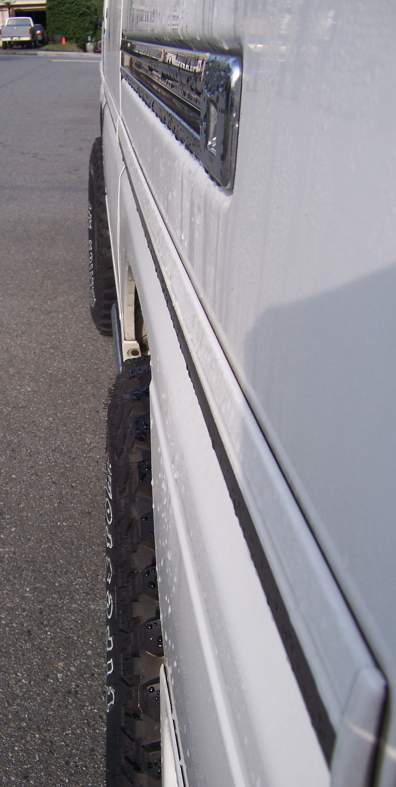

I recently bought a '92 Excel for my wife as mine didn't fit into her work underground (6'6"). It took her less than 1 hour to get used with the LHD and now she loves it! :-D But she didn't love so much that she kept on scratching the roof everytime she'd drive into her underground. (Nice yellow marks on the roof now, compliment of the warning bars).

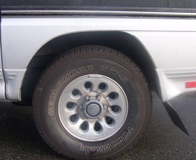

So I had the choice between getting smaller tires or lowering it. Didn't feel like increasing the revs by putting smaller tires so I took her van to Canada Springs and went the opposite direction as Falco... I got them to re-index my leaves springs. The van was effectively lowered at the rear by 2". The front was already low enough to clear and actually sits level now. I might lower the torsion bars a bit but I'm happy for now.
The side step by the sliding door was already lowered by the previous owner in Japan... but all of those will be replaced by the chrome ones that I'm removing/removed from my truck.
Lowered, close up.jpg (58.71 KiB) Viewed 13001 times
All I need now is to find some nice larger rims with lower profile tires to fill the wheel arch nicely but that's for later... AND just to keep the record straight, this one is a city Delica that likely won't see any mud but will still come handy when we have snow for 5 days/yr to drive up where we live (way up on a hill).
Hers and his....jpg (65.43 KiB) Viewed 13027 times

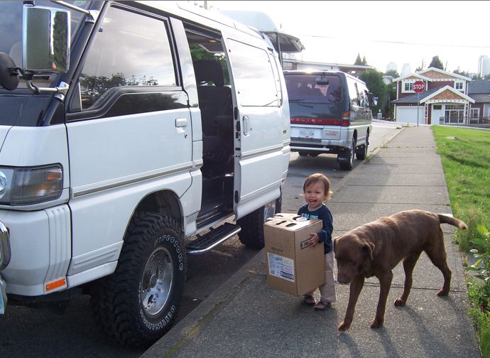

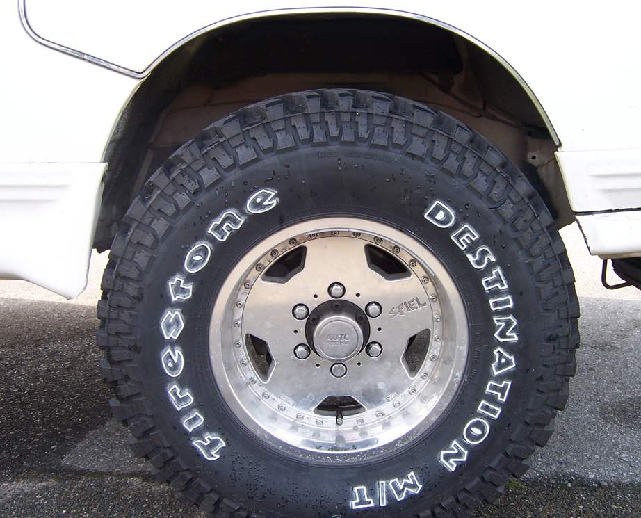

As far as mine goes, I went the other way and jacked it up. I'm not done with the project yet, still have to install my rear shackles but it's getting there! So this is what it looks like when you re-index and crank your torsion bars, you can see how the front sits higher than the rear (I kinda like the look actually). I also put some new mud 31" that I love! They aren't very loud on hwy but offer tons of traction offroad. (I also had to put new wider rims as my originals were only 6 1/2") I was out with Falco last weekend in Chilliwack and although he's got all-terrain he'd be slipping on many occasions while I thought I was on dry pavement!
Here's my little one getting trained on WVO use, he already loves it!
My helpers.jpg (73.78 KiB) Viewed 12994 times
This picture is before I re-indexed my torsion bars... Those rims are actually Split-rims that come apart, nice! And they are really thick, nice again!
Front tires.jpg (91.71 KiB) Viewed 13010 times
Tires, side view.jpg (37.04 KiB) Viewed 12983 times

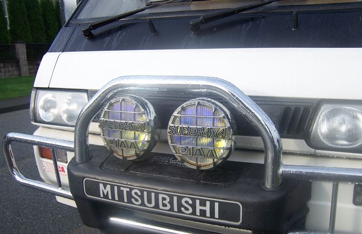

I also got some new/used foglights that come with a high/low control. These things are BRIGHT! They came handy last weekend as well...
New fog lights.jpg (67.08 KiB) Viewed 12983 times

Yes, lowering it means I can't carry as much as before but since this is a "cool soccer mom minivan" I didn't care too much. It still find for most application except a full load of gravel... The cost was under $400.
The van rides fine, only when hitting a very sharp bump I hear it at the back but I might still have to do some minor adjustment. Could also be the exhaust hitting the springs... I could have lowered it 1" or 1 1/2" with less issues but I just asked them for as low as possible while maintaining as much of the initial ride as possible. It does drive more like a sport car though, not a bad thing for a city vehicle. That's why I may lower the torsion bar so the front gets softer a bit (it's always been very stiff at the front compared to my other one).
