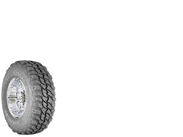

i need some rims for my new 30x9.5x15s herc T.D.M.T. s says i should have 7.5 rim. Im looking at 15x8s and 15x7s, what offset do i need do i just add an inch to the 25mm-30mm it says on wiki on the stock wheel for every inch the wheel gets wider?
