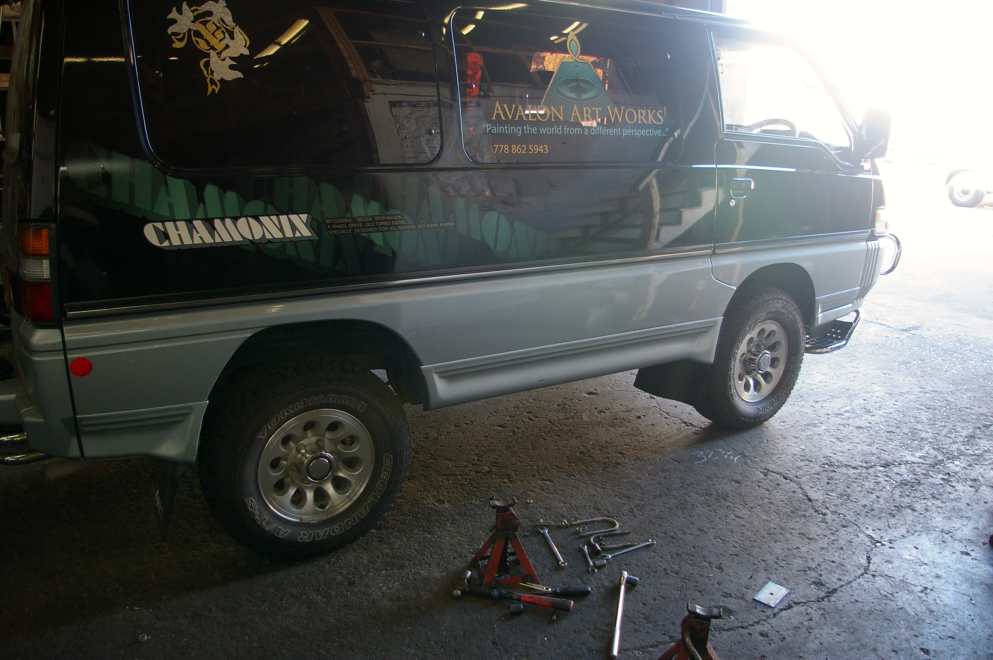

On go the wheels and down she comes off the jack.
Sitting Pretty.JPG (107.5 KiB) Viewed 23665 times
The Miss Lil' Bitchi's aft end is now sitting one inch higher than when she came in and is better supporting the weight that I typically have in my wagon.
