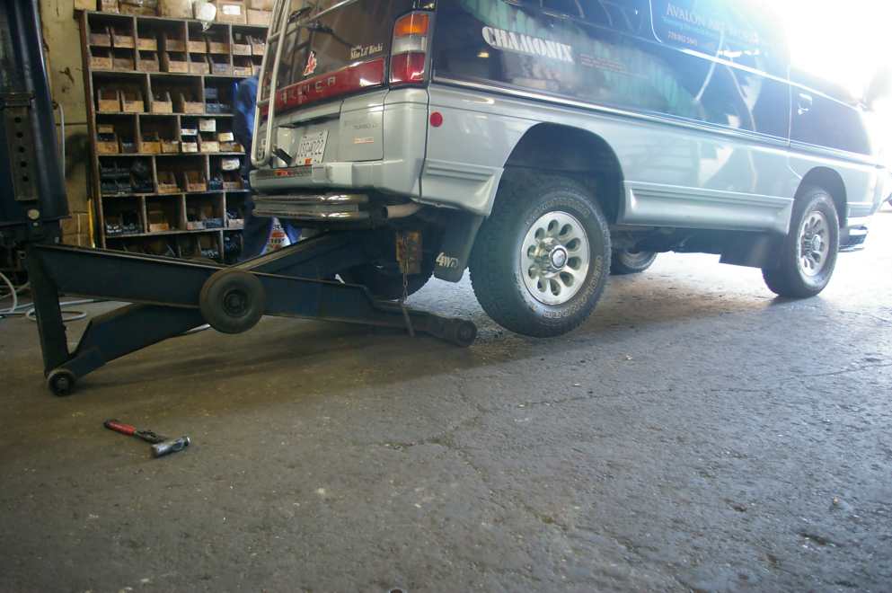

No sooner than I arrive that I am backing my baby into the garage and out comes this big pneumatic jack. Garyo told me that this is the place to go.... I bit my lip and smile.

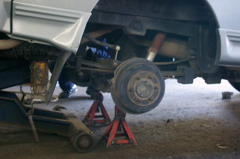

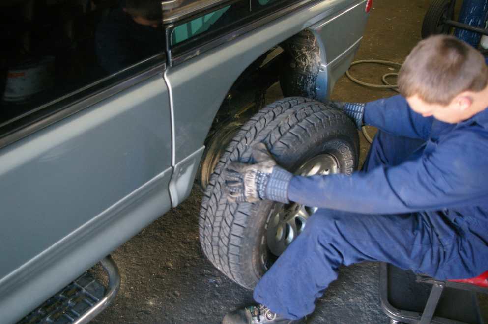

Zip, zip, zip ~ the rear wheels are off.

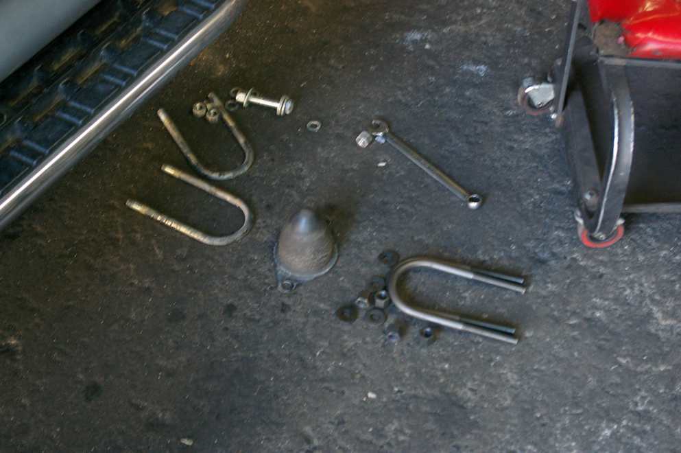

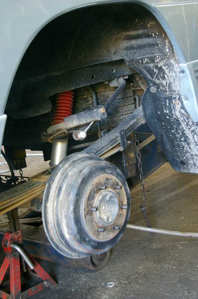

Gerry was very informative, explaining everything to me as he and his assistant, Joe, were dissembling the rear suspension ~ here the anti-sway bar is detached.
All The Bits.JPG (106.45 KiB) Viewed 23707 times
Everything was systematically executed. Parts grouped in appropriate places.

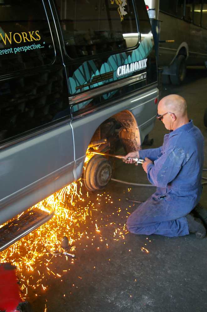

In order to take the leaf springs out (to modify them), there are these two steel straps, or braces that need to be detached by heating them up and bending them. And yes I was looking at how close one of them was to one of the fuel tanks.

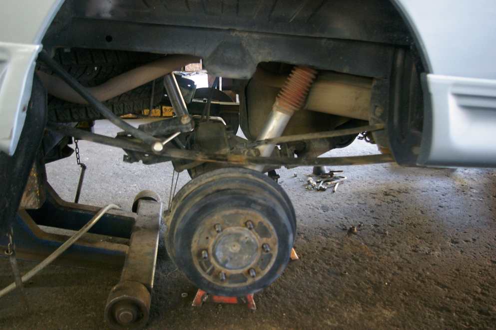

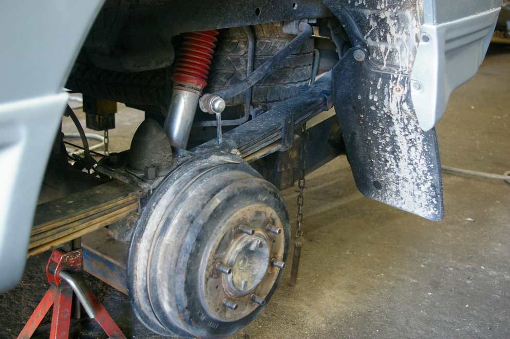

It's amazing how much you can see when the leaf springs are out of the way.

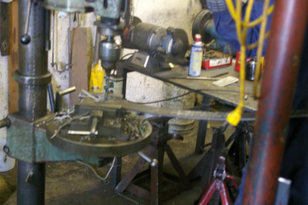

Joe bores the appropriate holes in the new leaf.

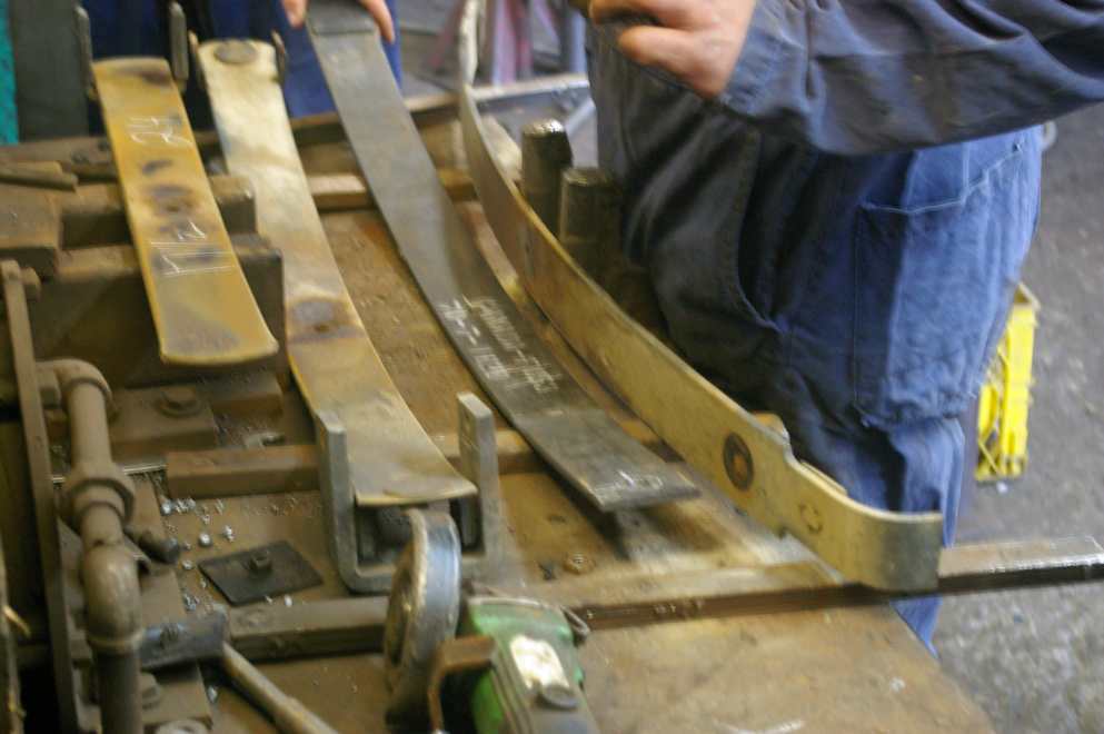

Gerry takes the leaf and shapes it to the correct arc that matches the other leaves ~ by eye.
Introducing The New Leaf.JPG (102.65 KiB) Viewed 23678 times
They are then assembled into the bundle that makes the rear suspension.

And putting it back together requires heating and bending the steel straps. It really was remarkable watching a man with the years of experience that he has (like most in the shop) manipulating these pieces of steel into a working spring system.
