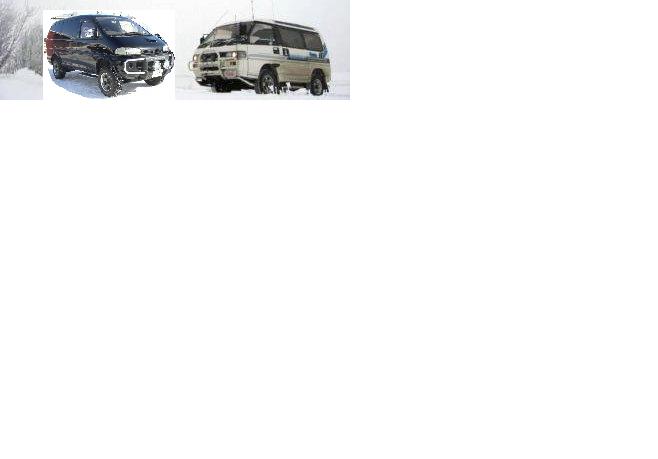

I'd like to hear more opinions on the L400 vs. the L300 models. I am aware of the style differences but does anyone have a mechanical opinion?
- L400 VS. L300
- L400 vs L300.JPG (13.91 KiB) Viewed 6991 times

Although it's generally a style preference, there's some very strong point of view between the 300 and the 400. On my recent visit to the UK I brought this subject with Bruce who's quite involved in the Delica thing. He and his mechanic (who's specialized on Delica) went over the common issues found on both the 300 and 400. At the end the 300 had a very short list of issues while the 400 had over 50!
And given that it's a new model, the serie 1 had more initial problem than the serie 2 (which came 2-3yrs later)
Good luck anyway, it's inevitable that L400 start to show up on our shore. (unless Transport Canada...)

The L400 has a more powerful engine (2.8L vs 2.5 in the L300) and is known to be much more powerful, the L400 also has a centre differential allowing you to use the 4wd on dry, grippy surfaces without damage (though why you would want to I don't know) (I know some of them have a centre differential lock to make them act like an L300 when engaged, however I don't know if it's standard or an option)
L400 generally has more toys.
The downsides though include the extra toys as it is more things to go wrong, early L400s sound a little less reliable, though that seems to have been fixed in the newer ones.
They are also available in both short and long wheelbase versions, but the long wheelbase version is roughly the same size inside as the short wheelbase version of the L300 and the short wheelbase version is even smaller, this is due to the fact that the engine is now out front making for a longer overall vehicle with less interior space. Now the upside to that is that without the engine "hump" you can actually move from front to rear inside without too much difficulty.
The L400 is generally considered worse for serious offroad than the L300, though it is often described as being simillar in ability to a Land Rover "discovery" so it is not completely hopeless.
I've also been told, though I haven't been able to see one first hand yet, that the L400 doesn't look as ugly in person as it does in photos... but I'd have to actually see one to believe it.
